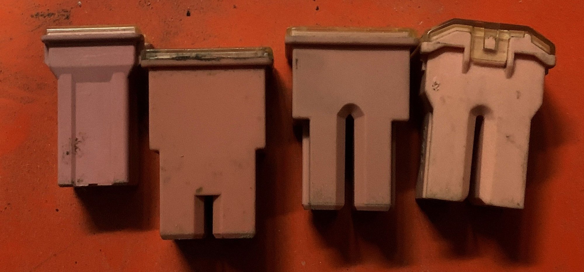

3. i have several different types of fuses, i didnt realize the difference in these particulr 30 amps until i was trying to install them (attached) are you familiar with what the difference for which they are used?
all 30 amps, one type has long slot on bottom, yet different type of top (one flat, one domed) another has short slot on bottom and cant be installed in PDC, and the last one is 30 amps but skinnier and shorter (hope the pictures come thru)

Jump the relay for the fuel pump, and check and see if you are getting power back there. If you are, plug in the pump, doesn't need to be in anything at all, see if the pump runs when you turn the key on. (or, have someone else turn the key on....)
If you need fuses, take your dead one to the parts store, they will be able to match it up for you. Lots of different types..... no clue why the manufacturers felt they needed to do it that way.

why the different style 30 amp fuses?
i was asking about the fuses as a general question, i have the correct fuse, i was hoping you would be able to explain the reason for the diffetence in fuses, or possibly another member of the forum would be able to answer . thanks for your help.
how would i ask a question such as that to the complete forum?
four different 30 amp fuses, what is the different uses?
Old Nov 16, 2019 | 08:59 AM
Posts: 87,475
I think part of it has to do with how quickly the fuse will blow. Some will allow a greater amount of current, for a short period of time, than they are actually rated for. Others, will blow as soon as the load exceeds their rating. Other differences are simply because the manufacturer wanted them to be different...... Which seems like a bad idea to me, but, no one consults me when designing electrical systems for their cars/trucks.
