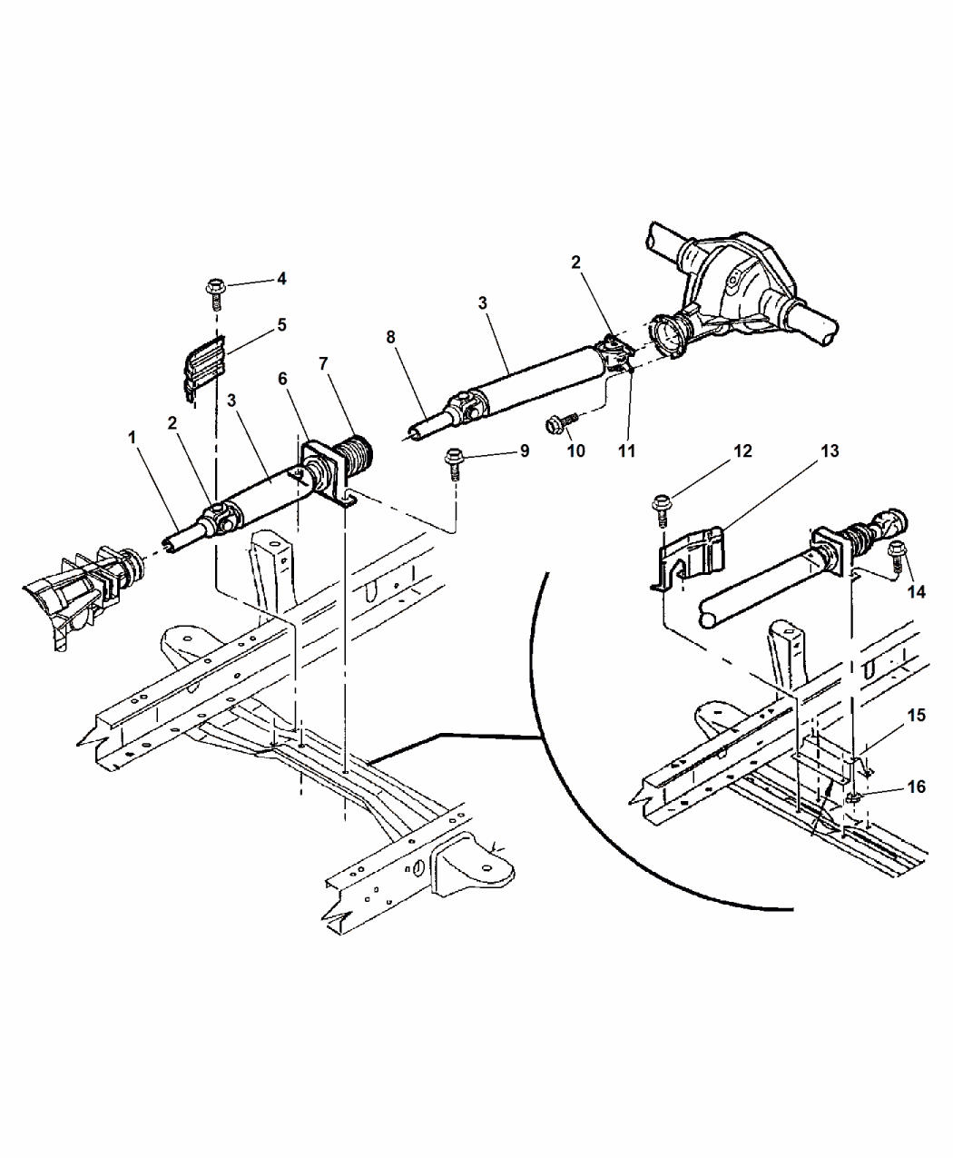

Found a quad cab using a different setup. On the quad cab it had a raised plate bolted to the rear crossmember with a dip for the driveshaft. I didnt buy it at first because I thought someone rigged it up. After looking up part numbers off the driveshafts, I finally found the figure I needed.
In the figure you will see the crossmember for the carrier support bearing on the left. This is what I have seen on club cabs. In the bottom right corner you will see a different configuration for the stock crossmember on auto quad cabs. Dodge bolts a raised bracket on the stock crossmember and mounts the carrier bearing to that. #15 in the bottom right of the photo.
I hope this helps someone in the future. I'll try to post up pics once I get started swapping driveshafts.
https://www.dodgeparts.com/v-2002-do...ropeller-shaft
