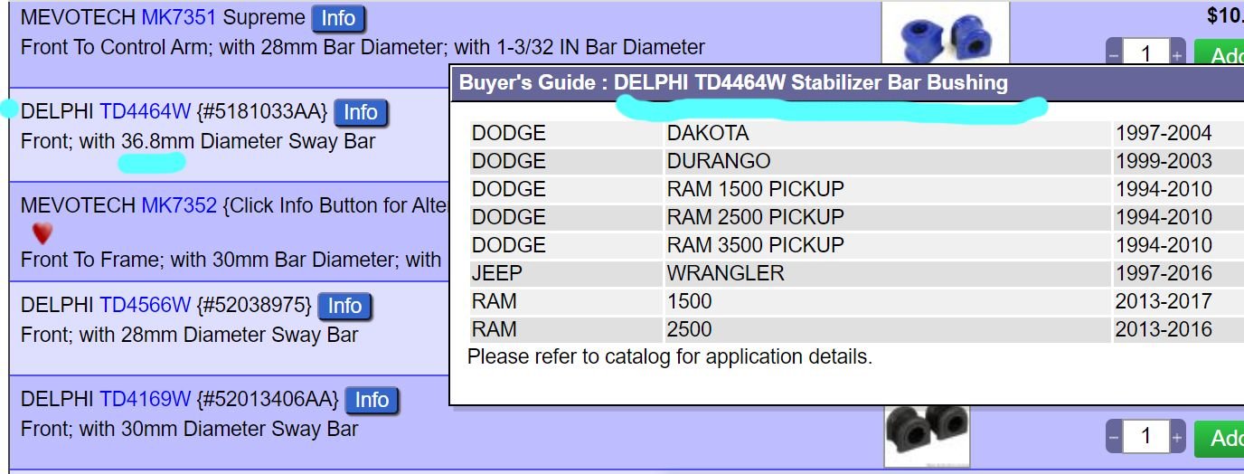

A Dakota with the 2.5 L engine has the smallest size sway bar so a better bar is a good Idea. A same year Dakota with the V8 will have a larger sway bar so a used junkyard bar may do you but that can vary.
measure your bar go check out a same year with a V8 in a junk yard the 2.5 has a 28mm bar.
