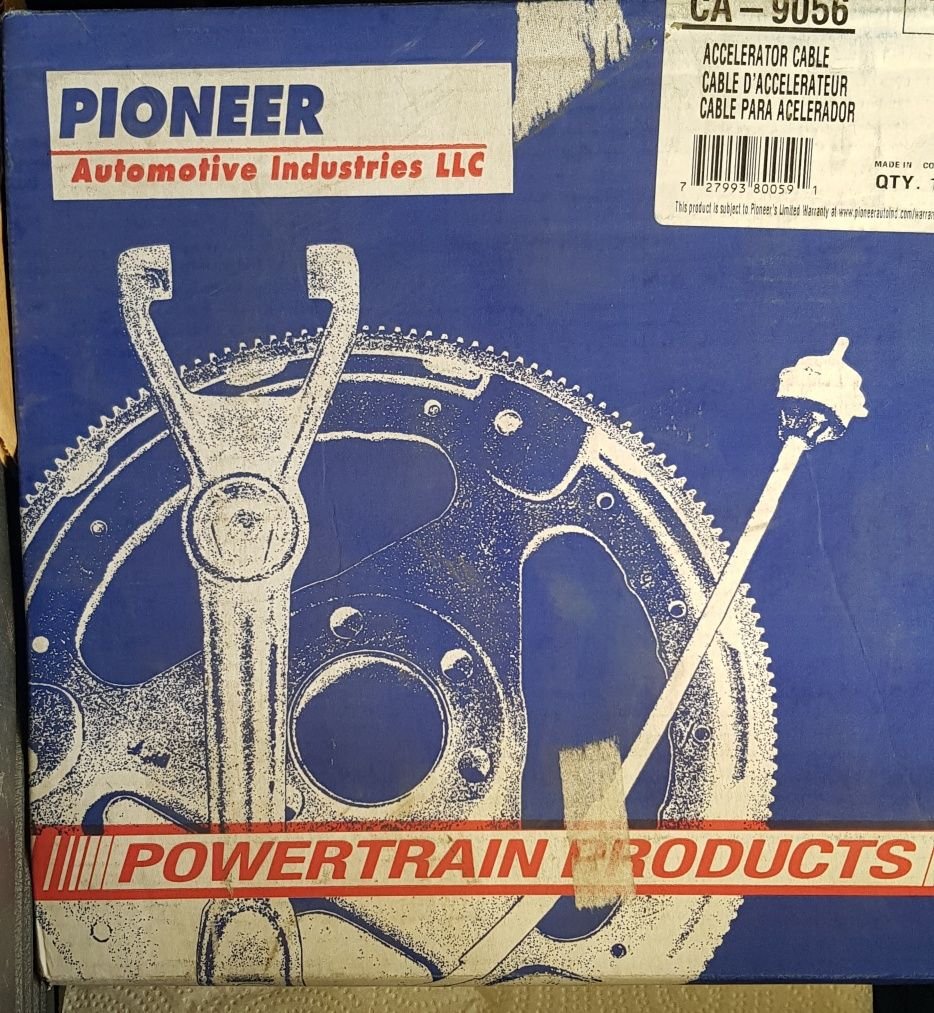

Default Found this at O'Reilly says 1998 $34.00
P/N CA-9056 will try on my 97', stand by ......

So here is what I found: The lower cable is the 1998 version, the cable on top is my original 1997. You will notice little round nosed crimped-on ferrels, the difference from nose to nose is about 0.900. This difference would not allow the throttle plates to fully close, can't use the 98' version cable.
What you don't see is the second crimped-on part under my thumb, this is where the problem is, it would appear this ferrel slipped rearward a good amount and this is why it will not get full open.
So I made my own custom stopper nut out of a long coupler 10-24 nut, I drilled and tapped two 8-32 holes, inserted the cable through the long nut and pinched the cable with two 8-32 set screws. Total cost: $1.95 and a few hours of engineering.
