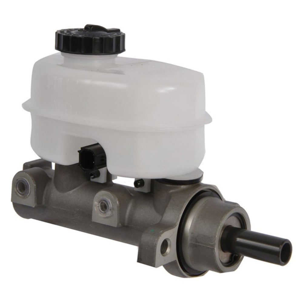

This works on Silverados for the brake light, may work on yours. Assuming here that the fluid level is not low, which would be a legitimate red light alarm. See the wire plugged in under the reservoir on the master cylinder on the top picture? Unplug that and see if the light goes out. If it does, replace the sensor that the wire was plugged into. On the side opposite the plug, use pliers or a screwdriver to squeeze the clip holding the sensor in place, and slide it out. The images are for a 99-04 Dakota, and you can see what needs to be squeezed together on the bottom pic. I just linked them because they're pretty big pictures.

@Vimes I do not have a sensor there. I removed the two wire plug from the block just outside the master cylinder and read 10 vdc with the ignition in the on position, if that has any bearing. From what I can tell there is no low level sensor in the fluid tank, I am going to assume there is just a pressure sensor.
