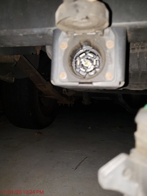

I'll take pics of the universal I installed, tomorrow morning. My SLT has the tow package as well. I'm curious, what tow electrical connector came with yours? Mine has a round one, I'll again check in morning which one exactly.
Thanks, but I wasn't sure if it was factory or if prior owner put it in, because there's also a Hayes Lemmerz trailer brake controller installed under the dash.

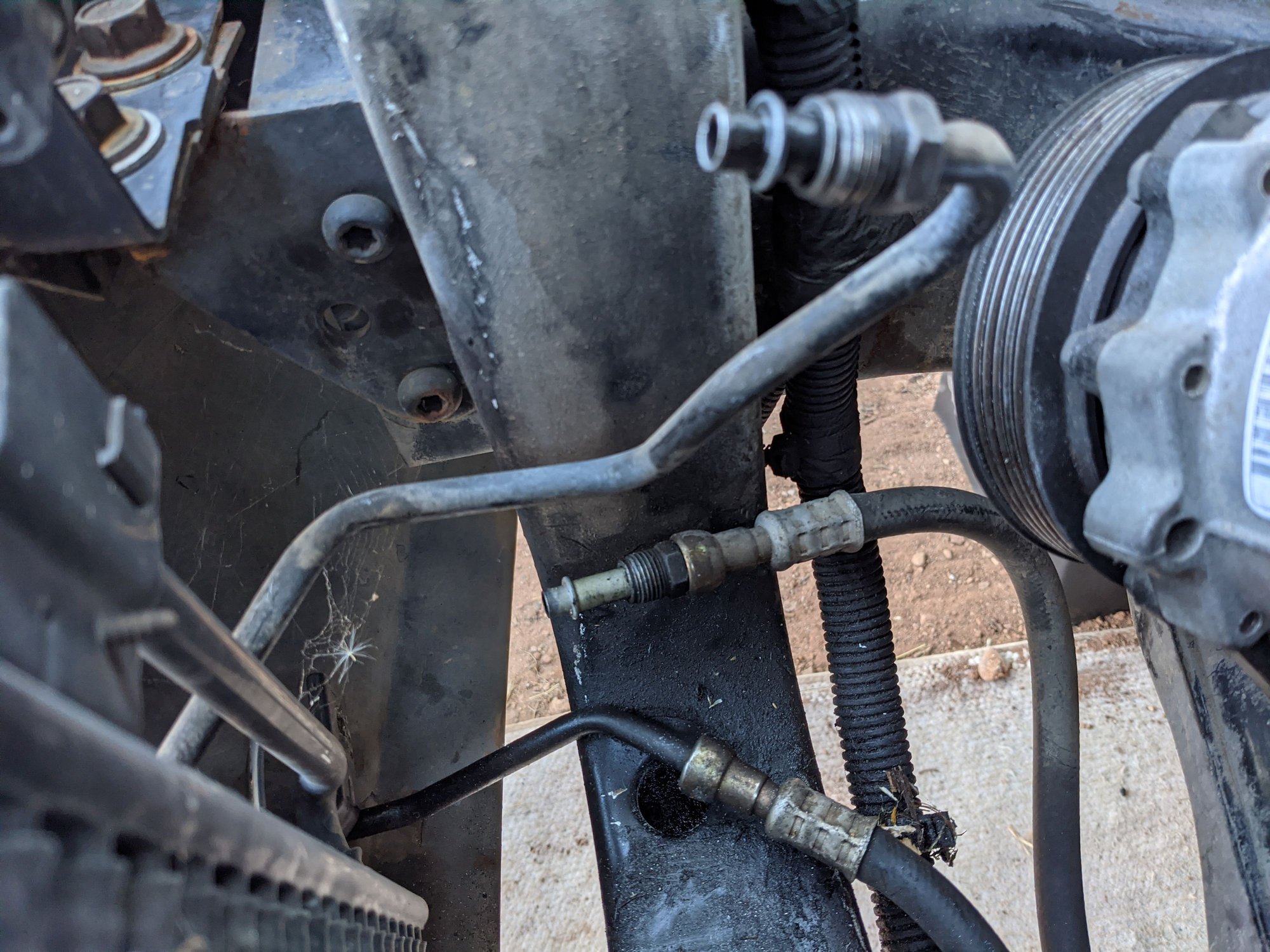

Was kinda difficult with the shrouding in place, but I was able to see a line running from the radiator to the cooler. It attaches to the cooler where the green arrow indicates, loops around to the back and enters the radiator just over the bottom hose. So this confirms that the radiator's heat exchanger is being used in series with the cooler. If you have the ability, go ahead and hook it up the heat exchanger, but if not, HeyYou's idea of a thermal bypass is a good one too. I had forgotten about those. They won't allow coolant to flow into the cooler till it reaches a certain temp. Another route is that most coolers come with plastic zip anchors that allow you to anchor it directly to the radiator, so the heat transfers right to it. Don't think that's possible in your case though.
