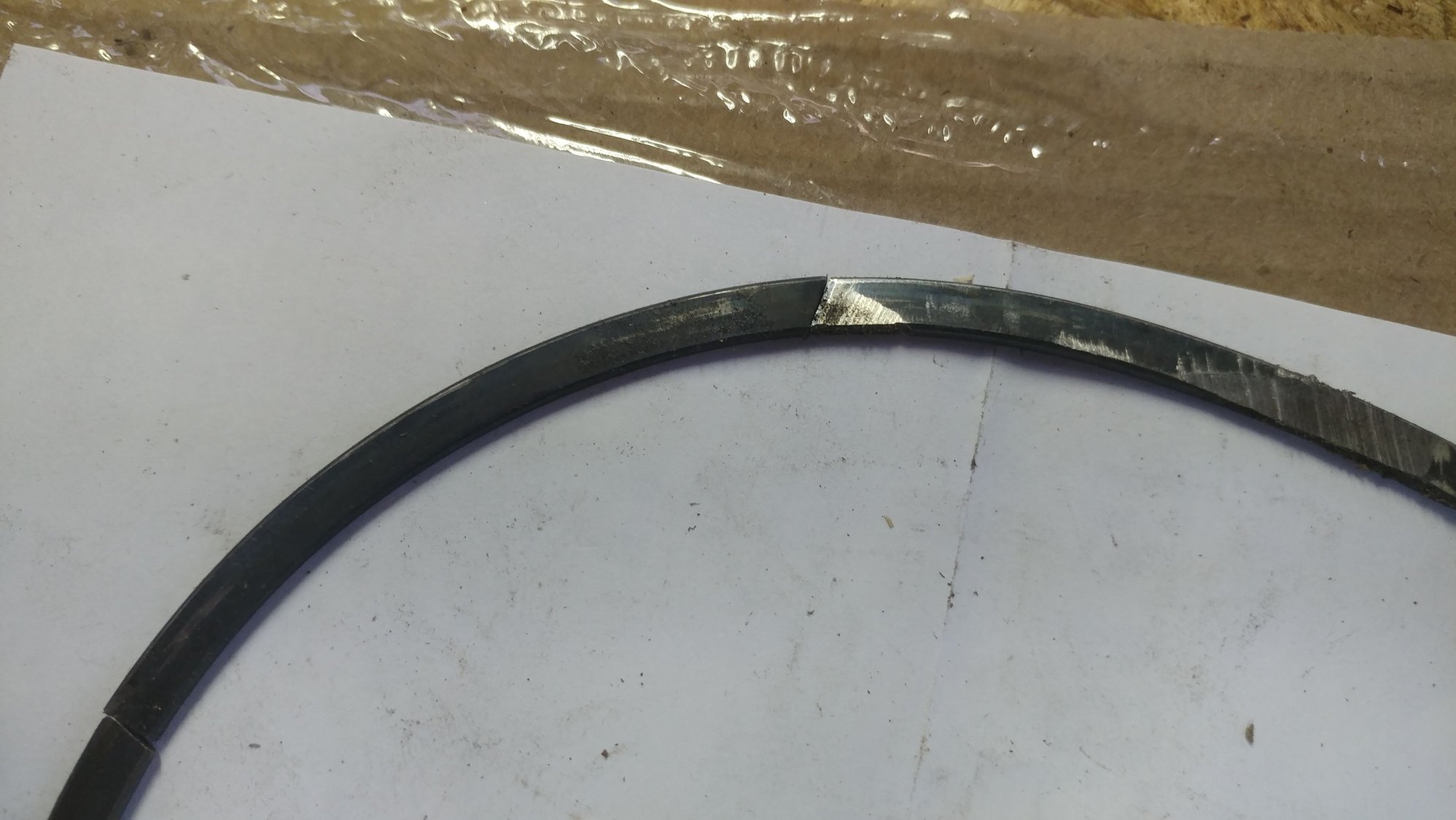

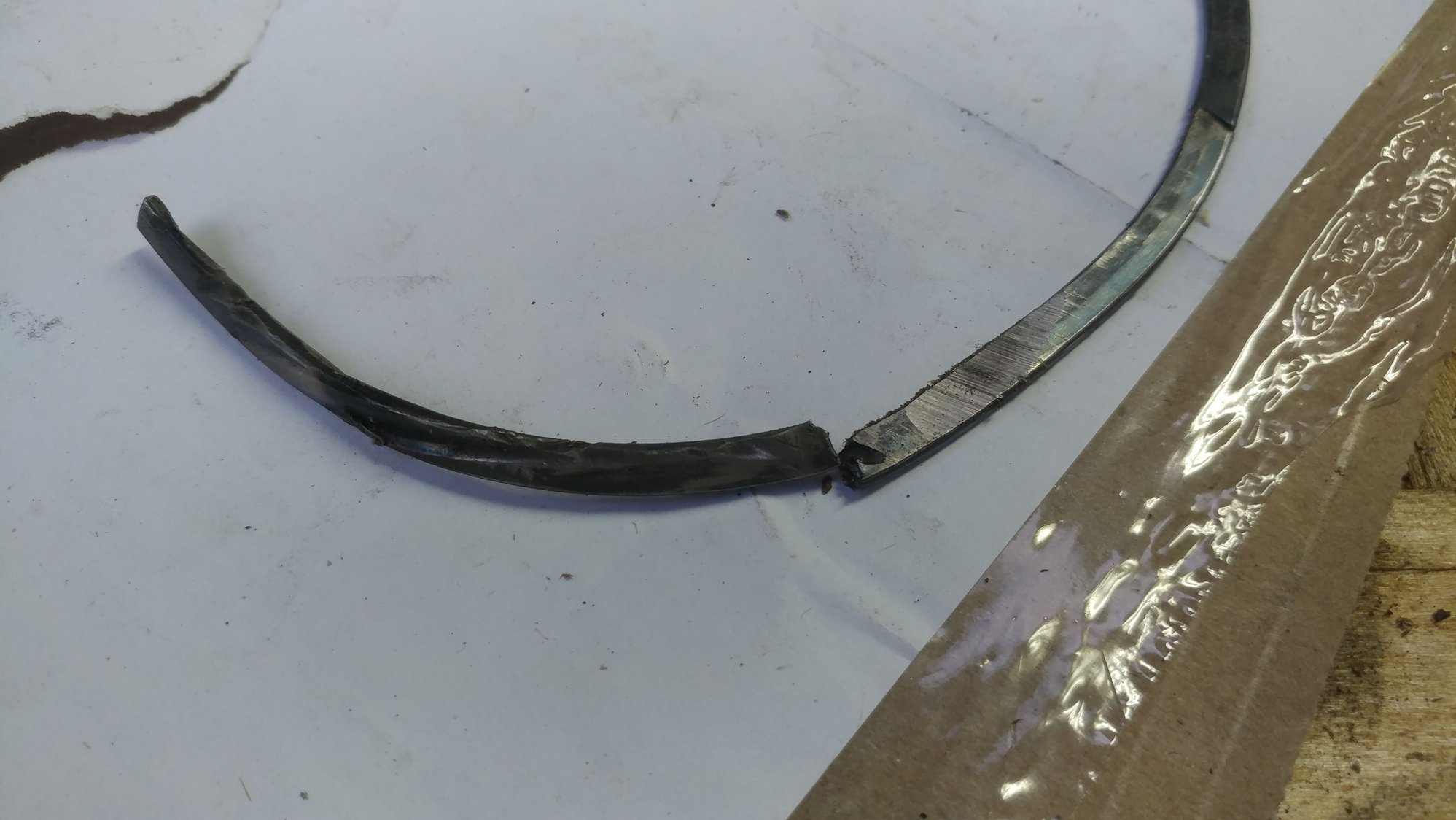

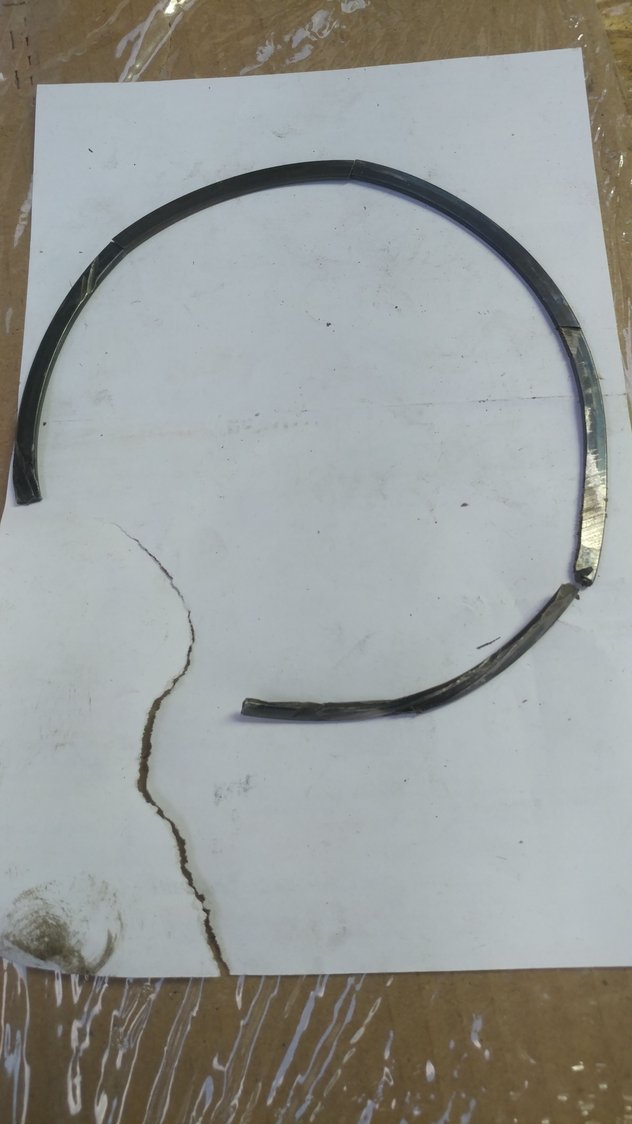

So, these are the chunks i fished out of the '99 trans that didn't have reverse! Kinda looks like it was a one piece ring at one point .... Any ideas where it's from?? A few pieces were in the pan, the others i took my magnet on a stick and poked around up and towards the back to fish these out. Might still be one more in there ....
