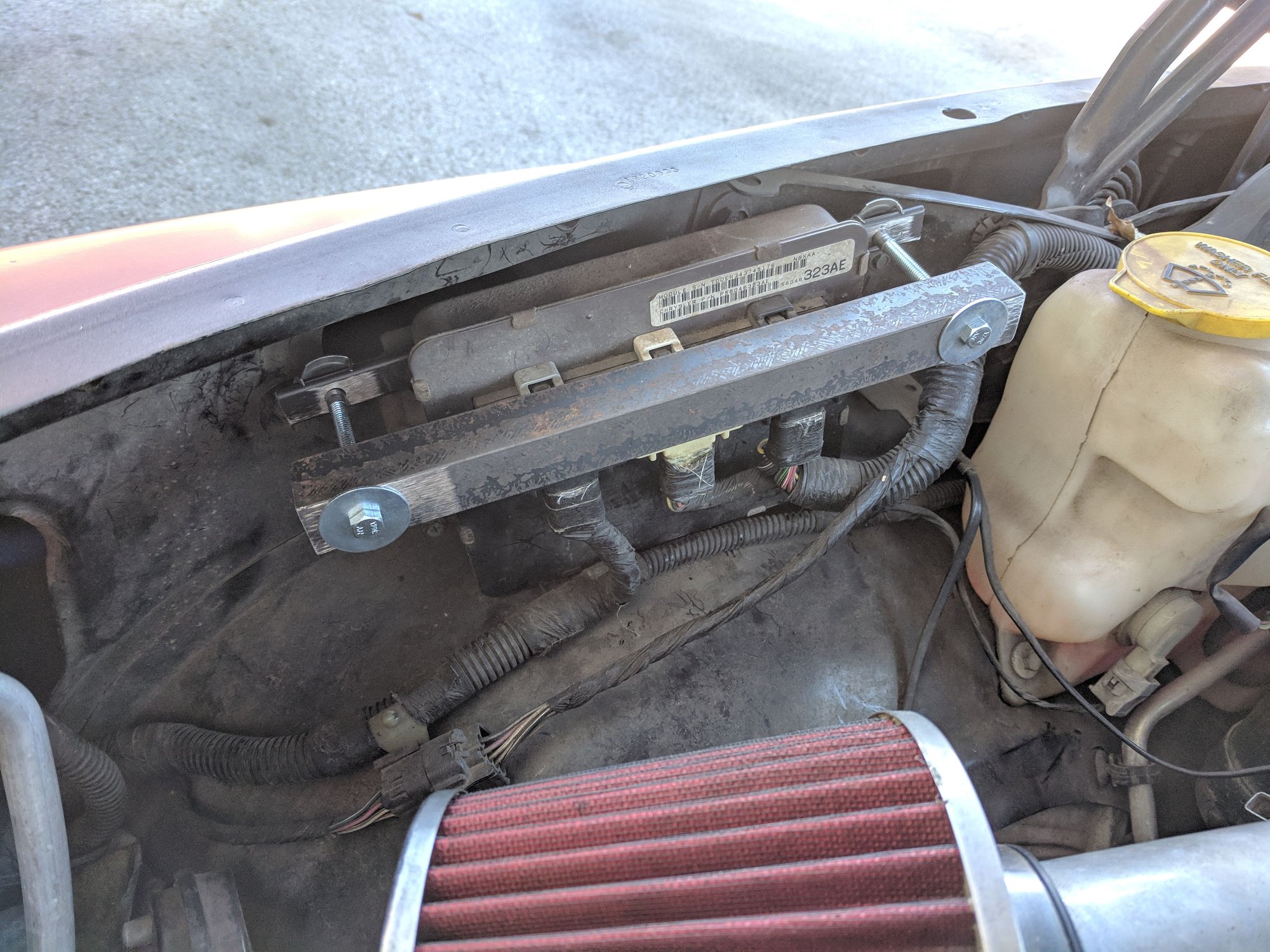

I had a similar issue, it turned out to be flexing in the PCM when warm. As I recall the JTEC PCM is filled with a gel potting that ages and gets temperature sensitive. It was a chase and miss for awhile before I got it to not-start one day and had someone to help me diagnose. Figured out if I held the center (white) connector tight, the truck would start and run fine. On the flip side, if it was running, if I gently pressed down on the connector, the truck would die. I ended up fabricating a bracket to hold all the plugs in flat.
Though during my studying of the issue, another cause for dying-when-warm was the two screws in the front of the PCM being too long. Apparently as the motherboard heats and flexes just slightly to short out against the screws and kills it until it cools off. The solution to that is either take the screws out and carefully sand/cut a little off them, or make some spacers so the screws aren't as deep.
