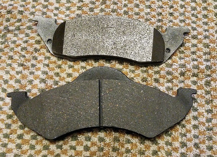

Yes I'm in the process of upgrading to 2000 to 2002 brakes I now have all new control arms calipers and a good set of used 2001 spindles ready to go.
I just didn't want to go to the 2003 or 2004 brakes as I would need new 17" wheels and rims.
These should be a big improvement over my small 98 Disk brakes they SUCK.
IV'E had brake problems from day one when my Dakota was new front and back brakes.

Well I was informed other if wrong thanks I still would need new tires and rims the 2000 to 2002 brakes should do just fine those pads are around 25 to 30% larger and the caliper piston is a little bigger with better pad control.
Cant wait to get it done in March that's the planed week I'm getting it done DIY.
small pad is my 98
