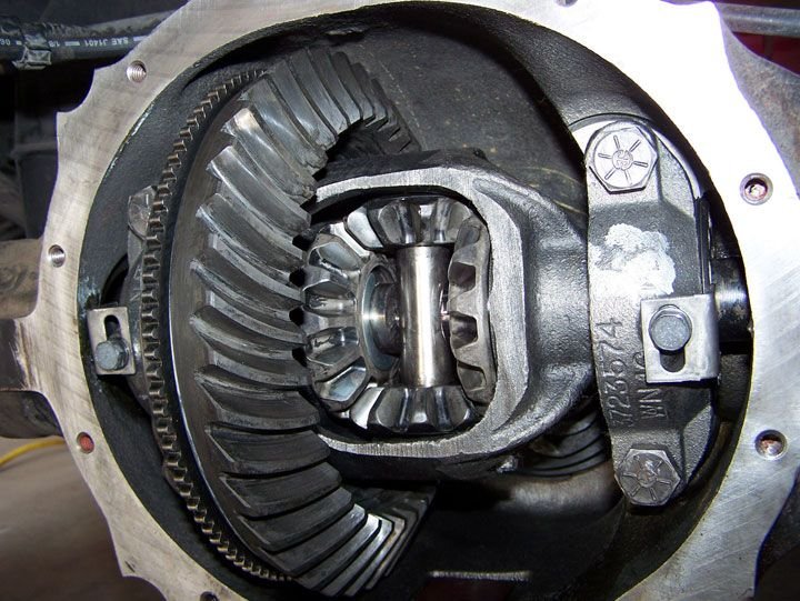

i was replacing the spider gears in rear diff all happy that the gears i bought as a hope work deal and they fit and worked woohoo...them my co-worker asked me how does the rear only abs know to work if there is know censors on front wheels? now its driving me crazy cause i dont know lol...anyone happen to know the answer

I don't think it matters it runs off the gear set, spiders will not affect the ABS. The sensor reads the large gear can't remember what that gear is called ring gear I think.
Old Dec 10, 2020 | 09:00 AM
Posts: 87,482
Should be a tone ring on the carrier in the rear diff. (goes between the carrier, and ring gear.) Sensor reads off that.
As for how the PCM knows if the rears are sliding or not..... on that, no idea. Not like it really has anything to compare it too... May it watches the rate of change in speed?

There is a magnetic sensor that reads the tone ring in the rear. When the wheels turn different rates, it picks it up and works the brakes. It works better than you might think.

That's correct it's not the ring gear it reads it reads the part attached to it.
PCM doesn't know anything about the spider gears, or individual wheel speeds.

The pcm just senses rate of decel. If the speed sensor in diff is un plugged abs won't work. I played with it on a hoist in my 03. It's all it can do without front sensors.
