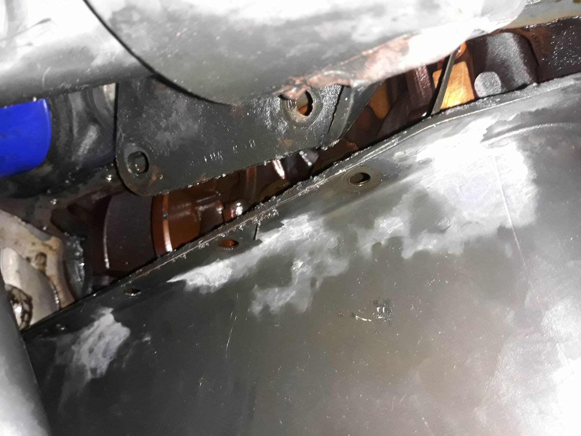

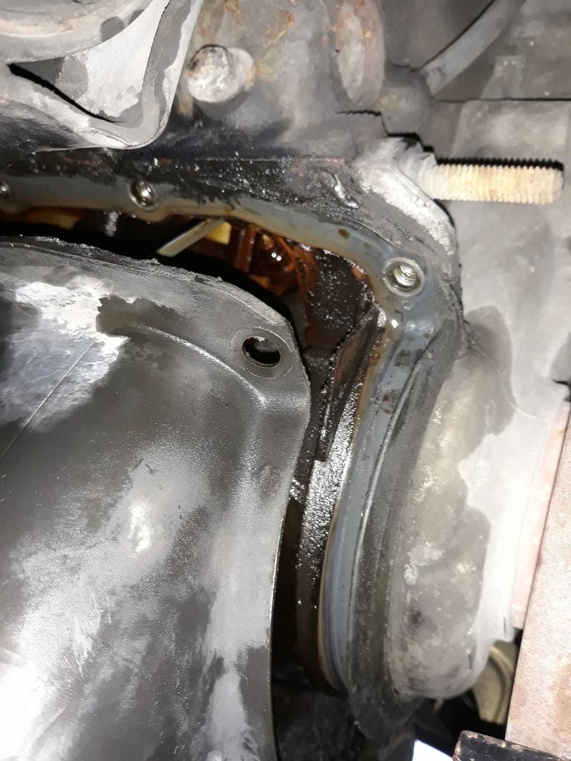

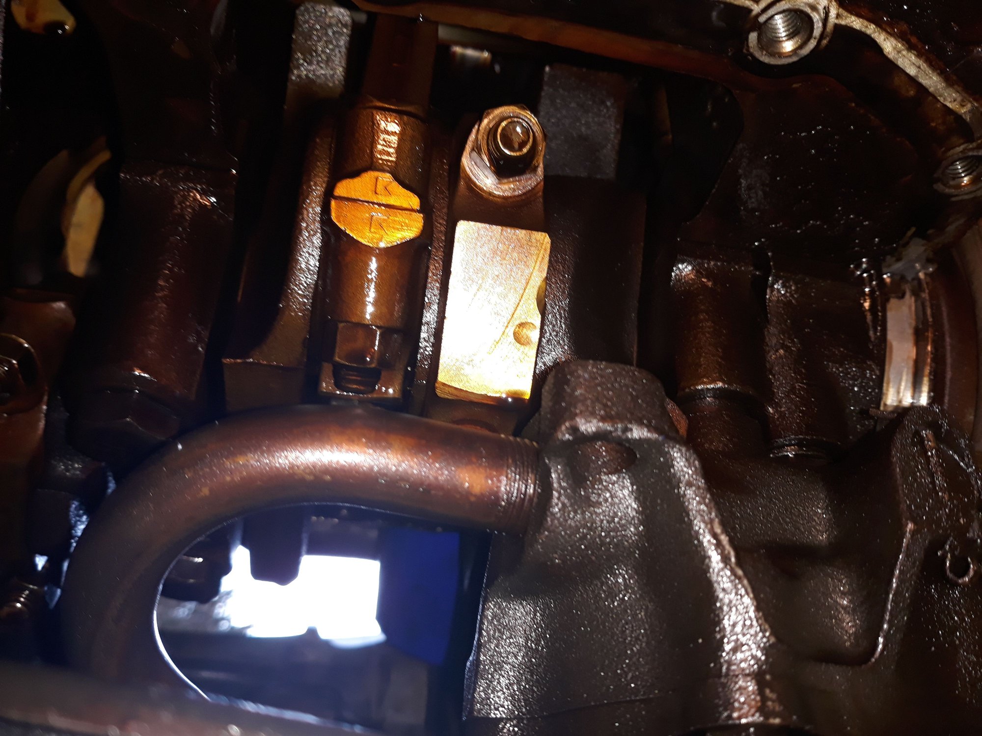

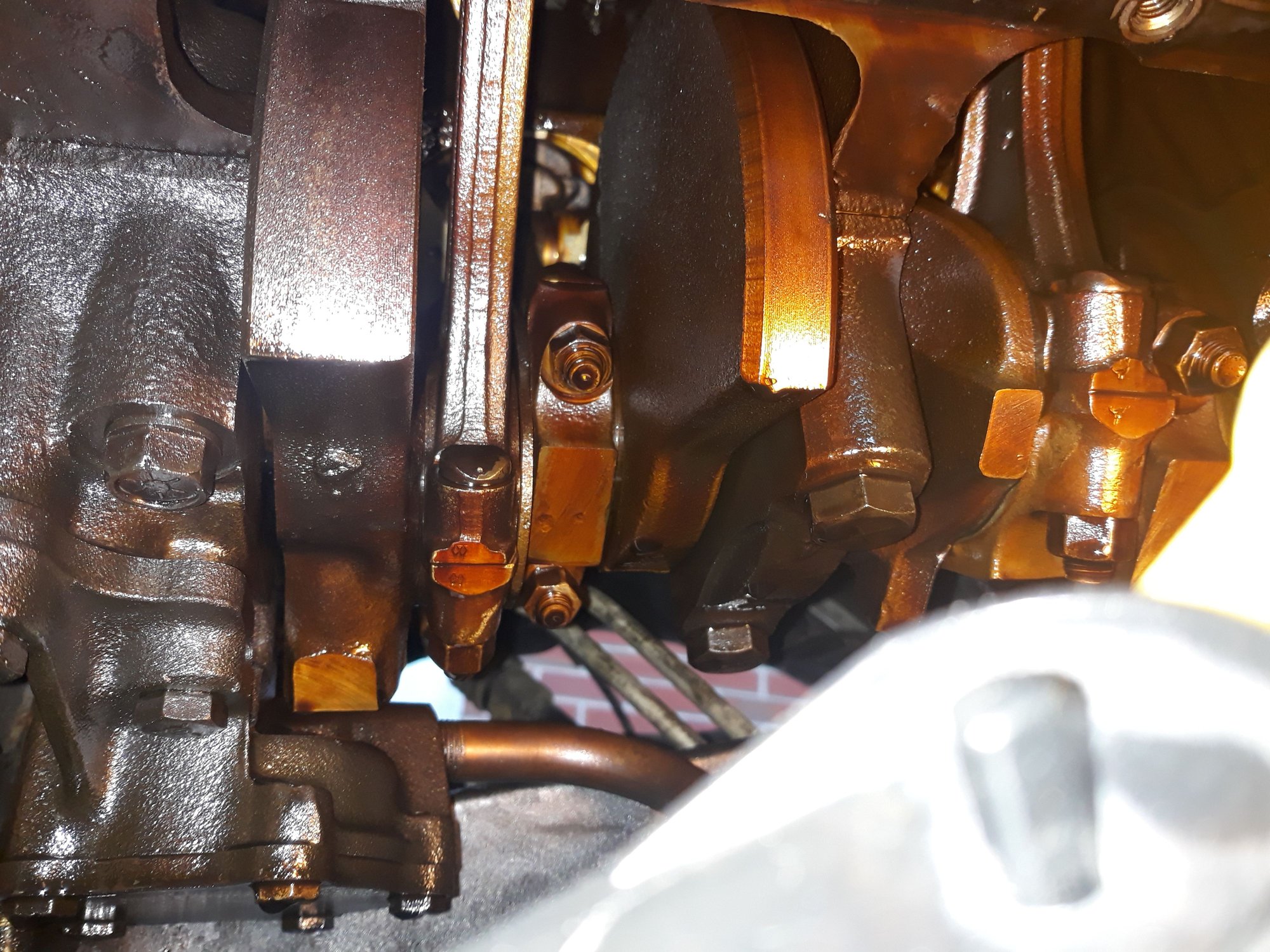

Got a little more space to manuver inside the pan now but it's still not off. I raised both areas to the max ,front engine an rear tranny area at overdrive support . I just cant get that 1 more inch angle for pan to clear!
I can get my hands inside there now though.
Can I get away with a gasket replacement now that I can get inside ,as long as I'm careful with clean up an fit .?

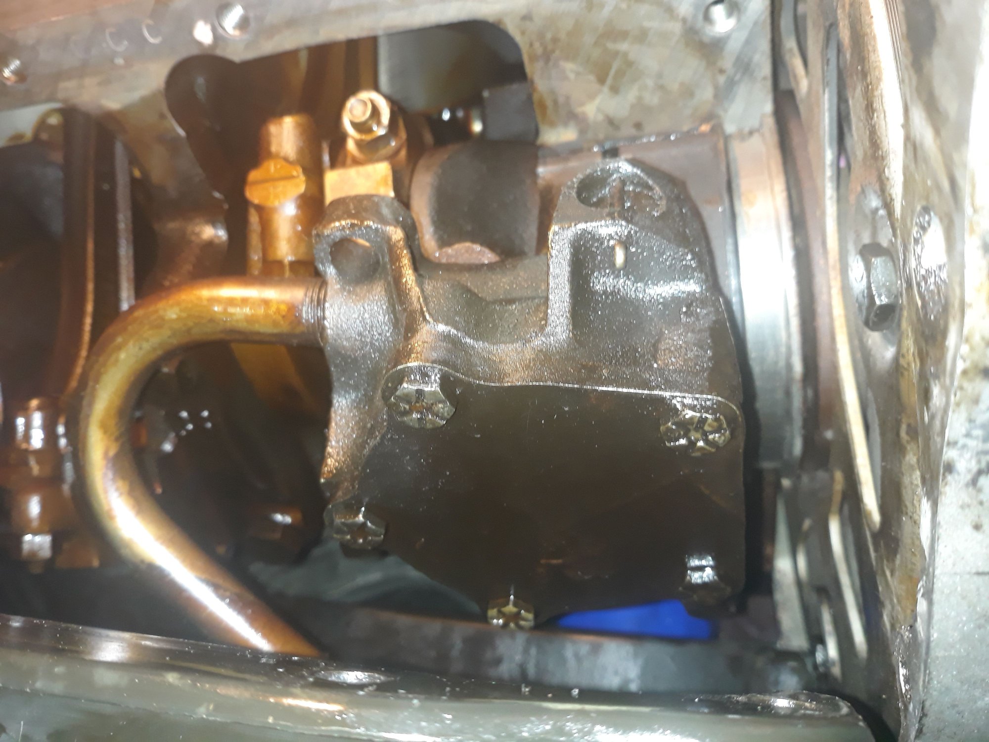

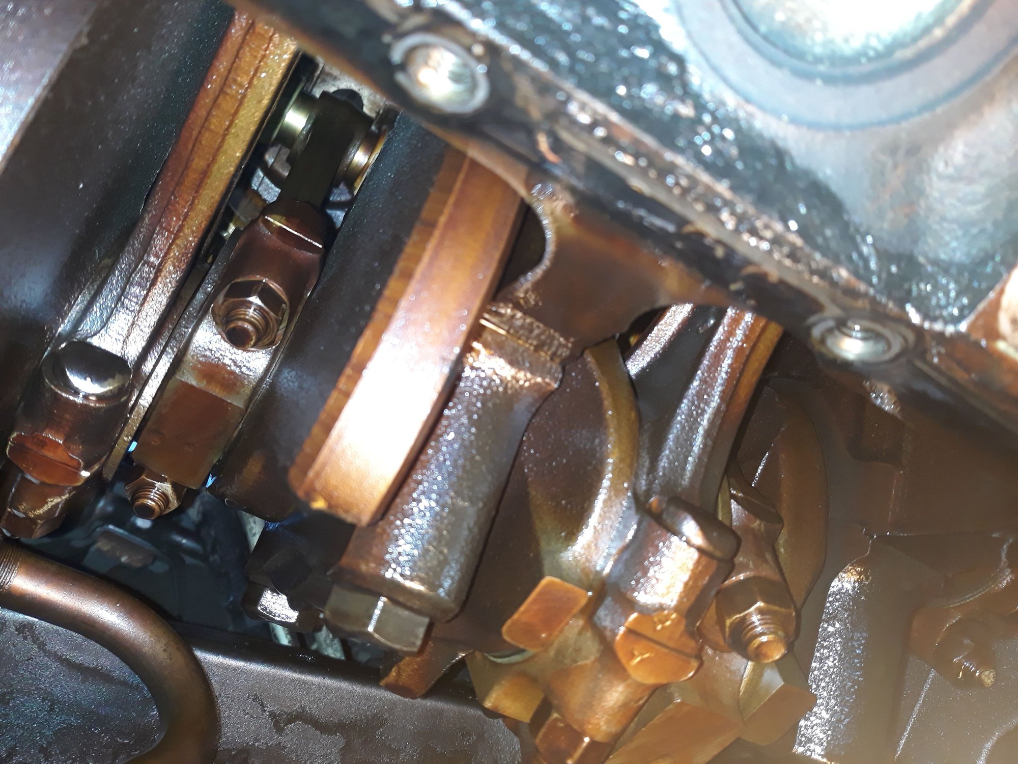

Heres a pic from inside area.
Does it look typical with nothing out of the ordinary ,?
Thanks
Old Jan 30, 2021 | 09:38 AM
Posts: 87,404
Likes: 4,214
I don't see anything just offhand that I would consider 'cause for concern'. Getting the gasket on there without damaging it might be fun though. Getting around the oil pump pickup ain't gonna be easy.

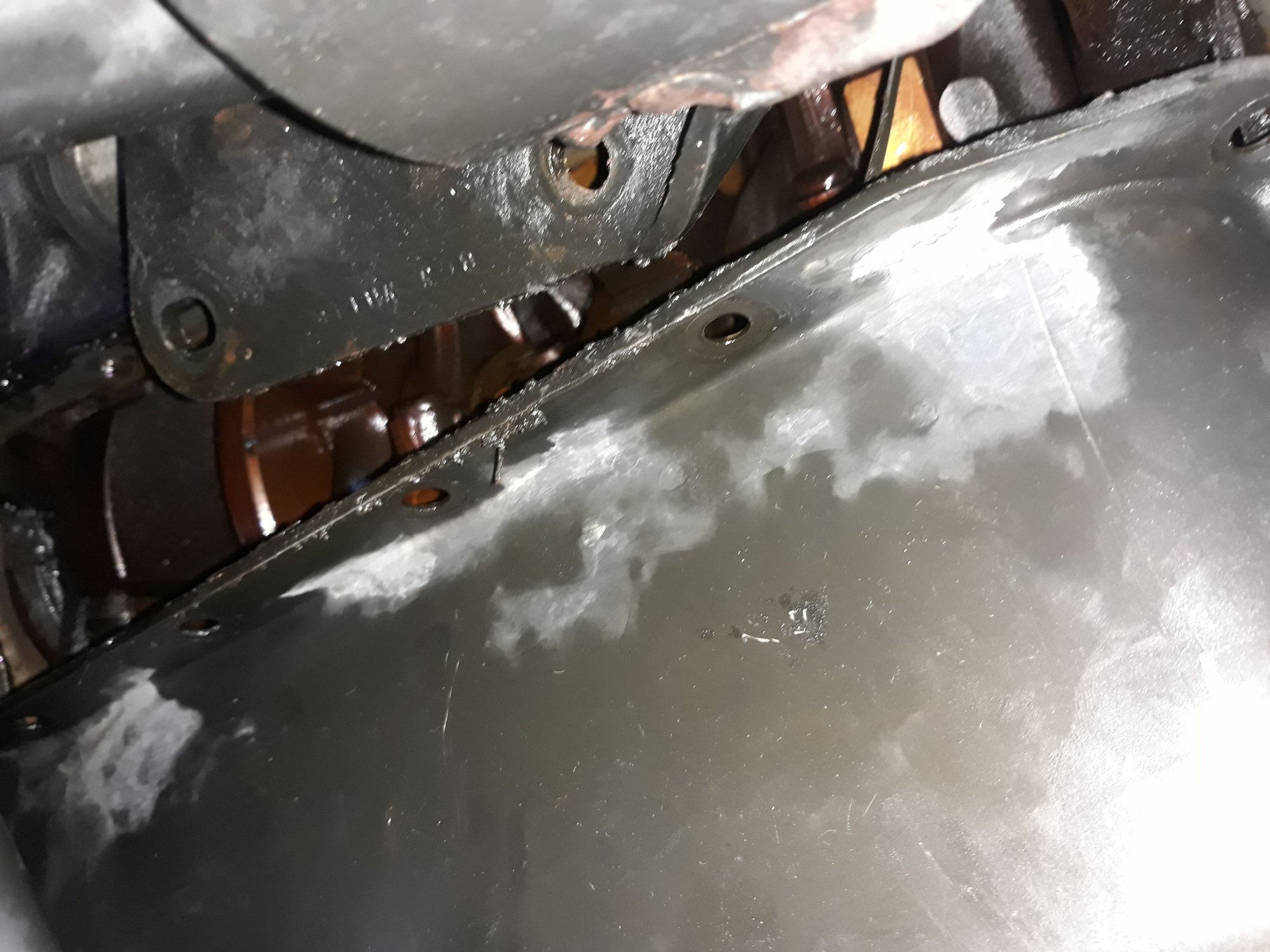

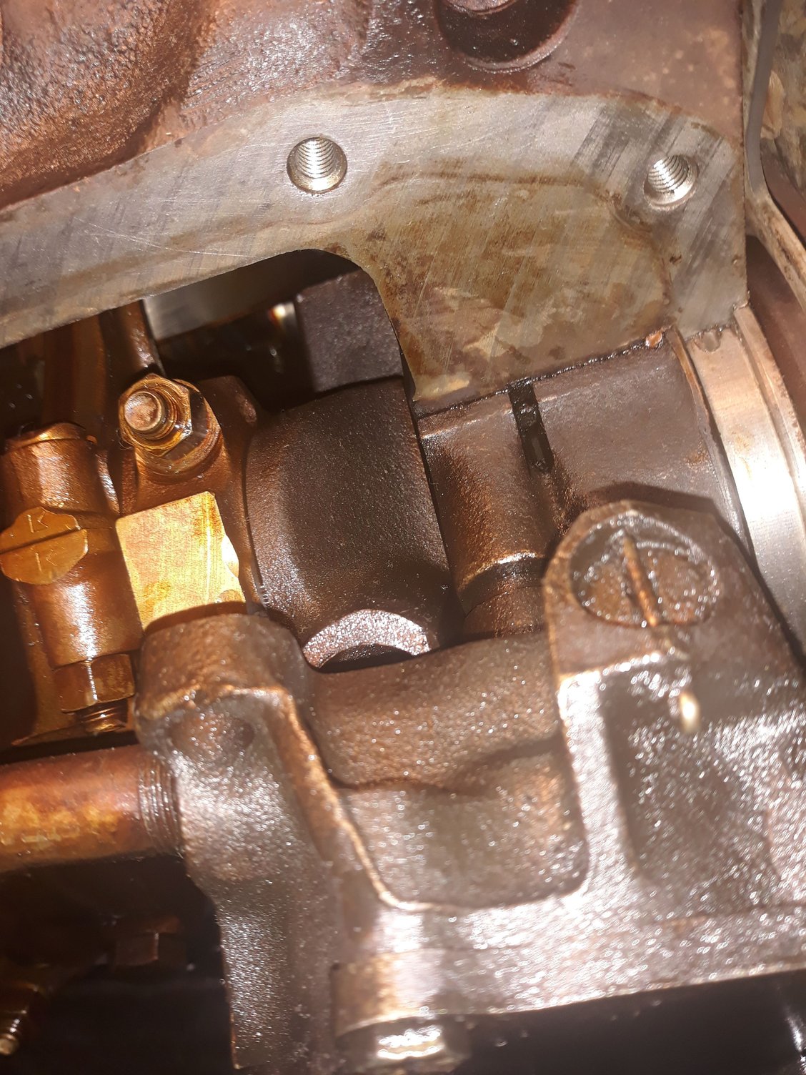

As low as I got pan I can clean it up ,put gasket down inside pan in a sideways way an fish over ..I can get my little hands in there pretty well for that[ doubt I could on main seal though] I'll place on pan an ,if needed use a piece of string or a dab of sealer or use a piece o aluminum tape at side to temporarily keep holes in place ,..then loosely bolt pan up all around using gravity on the pan to my advantage.
Will I need to use rtv at the curve points .. just a dab ?

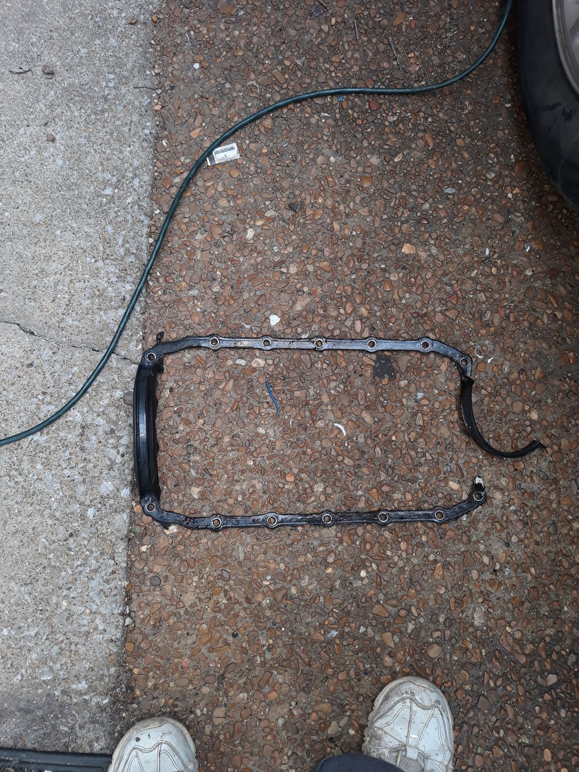

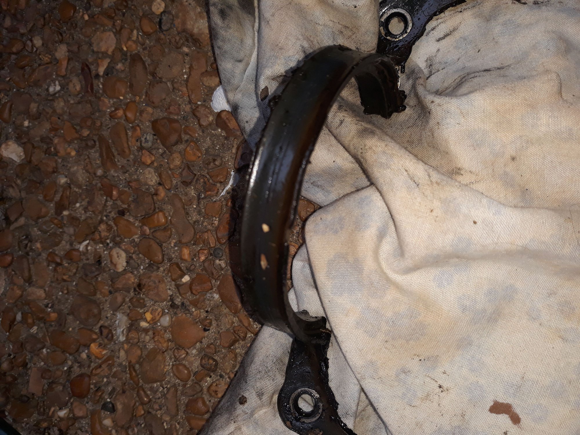

Heres old one .I broke it getting it off an it was intack/ fine before removal .
How can I tell if it was this vs the rear main leaking?
I saw a tiny drip at the bottom of bell housing only after driving.
Old Jan 30, 2021 | 12:57 PM
volaredon's Avatar
volaredon
Posts: 1,745
Likes: 50
yup that is how I did my pan gasket on my 99, just fished it thru around the oil pickup screen, I had enough room to do that but not to get the whole pan outta there... and I wasnt pulling the engine just for that.
