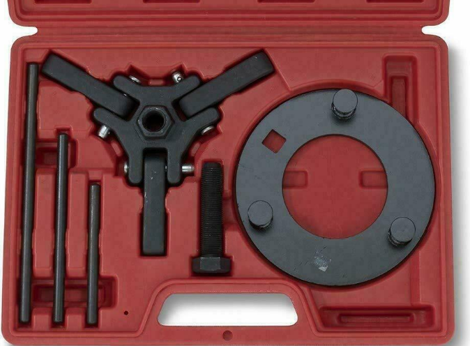

i also came across this tool albeit too late in case anyone needs it. it has the holder and the pulling tool
haven't verified that it would work with the 3.7L v6 but just by eyeballing it relative to the 3/8th square looks like it would
