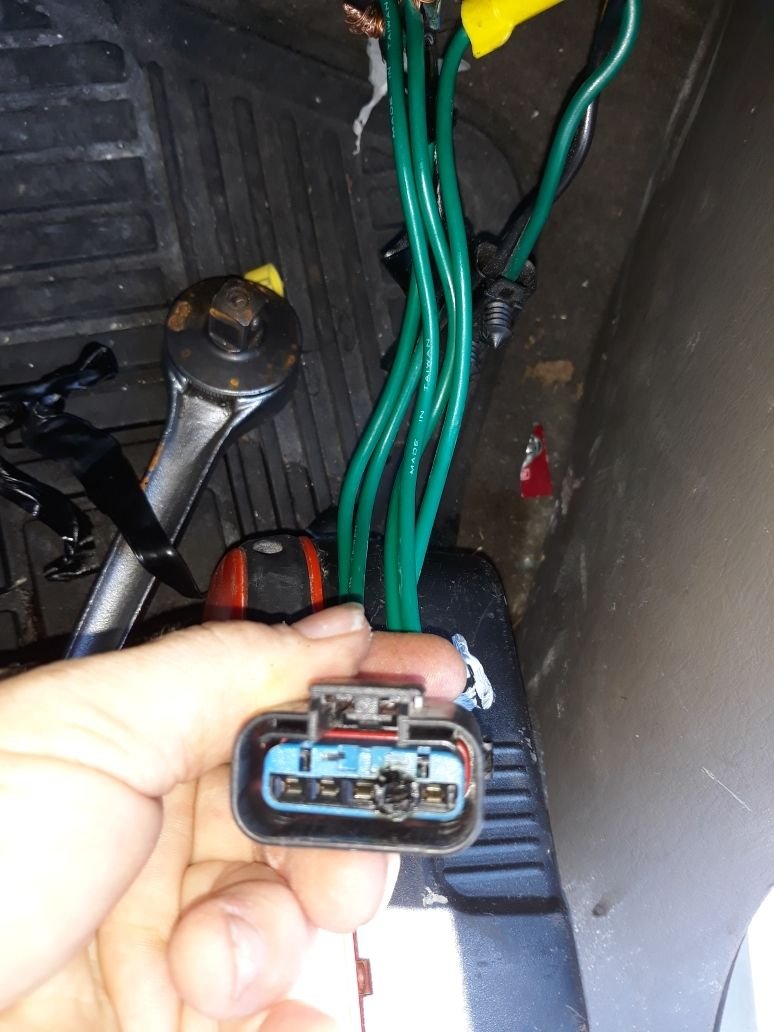

My truck had a burned wire on the plug under the blower motor. Splicing in a new plug fixed the problem. If this is your issue it will be blindingly obvious, because the plug will show signs of burning when you pull it out. It plugs straight up into the blower motor.

I went thru a few resistors an found the blower motor was causing it to overdraw.New blower helped.This is a common issue on these an especially if the wires to the resistor connection are the original thin ones .The resistor kit has larger wiring in harness .Look for a burn mark on the connector to resistor after unplugging it .
