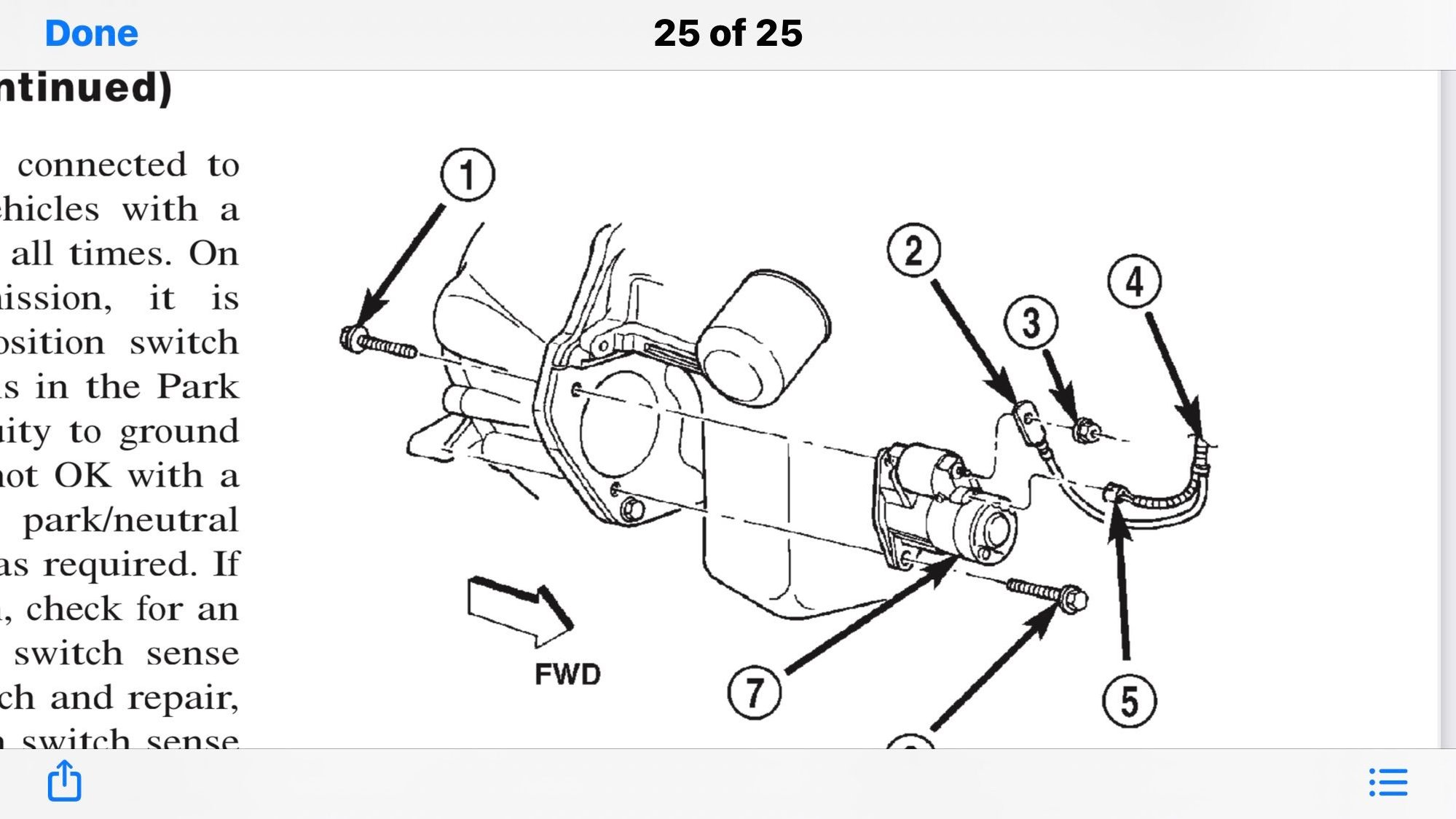

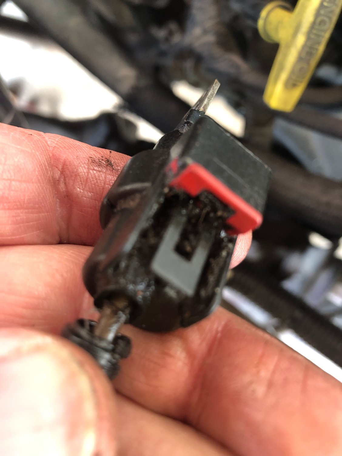

Hey - I am replacing my starter after 1 year. Other one failed. Question - how do I release this clip? I don’t want to snap anything off. #5 in the diagram.

Think you need to pull the red feller back a bit, then press down on the black tongue sticking out.

Is there something I can spray in there to loosen the gunk?
Or I'm thinking of just leaving the connector on and removing the new one from the starter.

Carb or brake clean, or electrical contact cleaner. Whatever ya got.

Got it open. Blew a little compressed air from a can in the joint and loosened some of the gunk out. Starter turned right over! Happy Day!!
