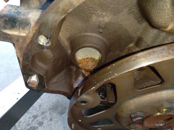

Why is it that out of all the freeze plugs on this motor, Mine had to rot out the one between the engine and trans??? Who is this Murphy guy and why are we bound by his law?
This doesn't look good..
She should've blown a long time ago..
But the Knucklehead previous owner put several bottles of "Mechanic in a Can" in there.

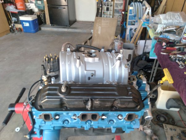

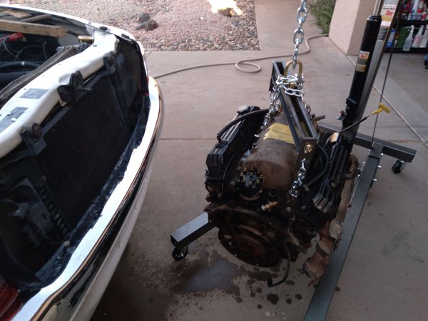

And on top of all that, Papa Smurf broke into my garage and had his way with my block!
Oh well, Something something lemons, something lemonade, Or something like that.
Cloyes double roller
Ebay belly pan. $65 shipped and really good fitment.
Ready to go back in:

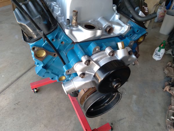

New water pump, painted timing cover
Cleaned and painted intake

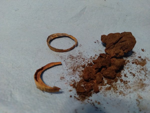

Huh, I never considered that it might be casting sand. When I took it out I grabbed a handful and it felt squishy like wood pulp, but after it dried out it is very finely ground and almost powdery. I just figured that was what is in those cans of stop leak. Also the rings in this picture were around every plug that I replaced. It is like a dried epoxy almost, but very brittle.

The powder is a combination of casting sand and rust. The hard curves are rust and chemicals from weak anti-freeze. You may find the engine cooling system is more efficient now after the repairs.

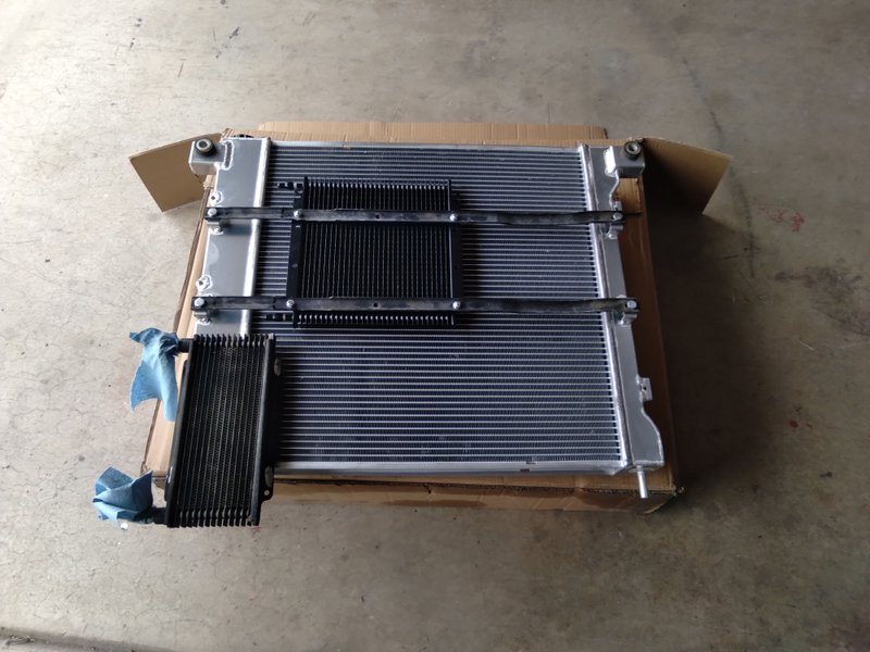

I hope so.. I put in a 3 row all aluminum radiator and a new trans cooler that is double the size of the old one.
I have taken it on a few shakedown runs so far and it seems to get up to 190 a lot faster now, but it has stayed there once it arrived, even when sitting at idle. It used to take a while to get hot, then slowly creep up and overheat if I didn't get it moving.
