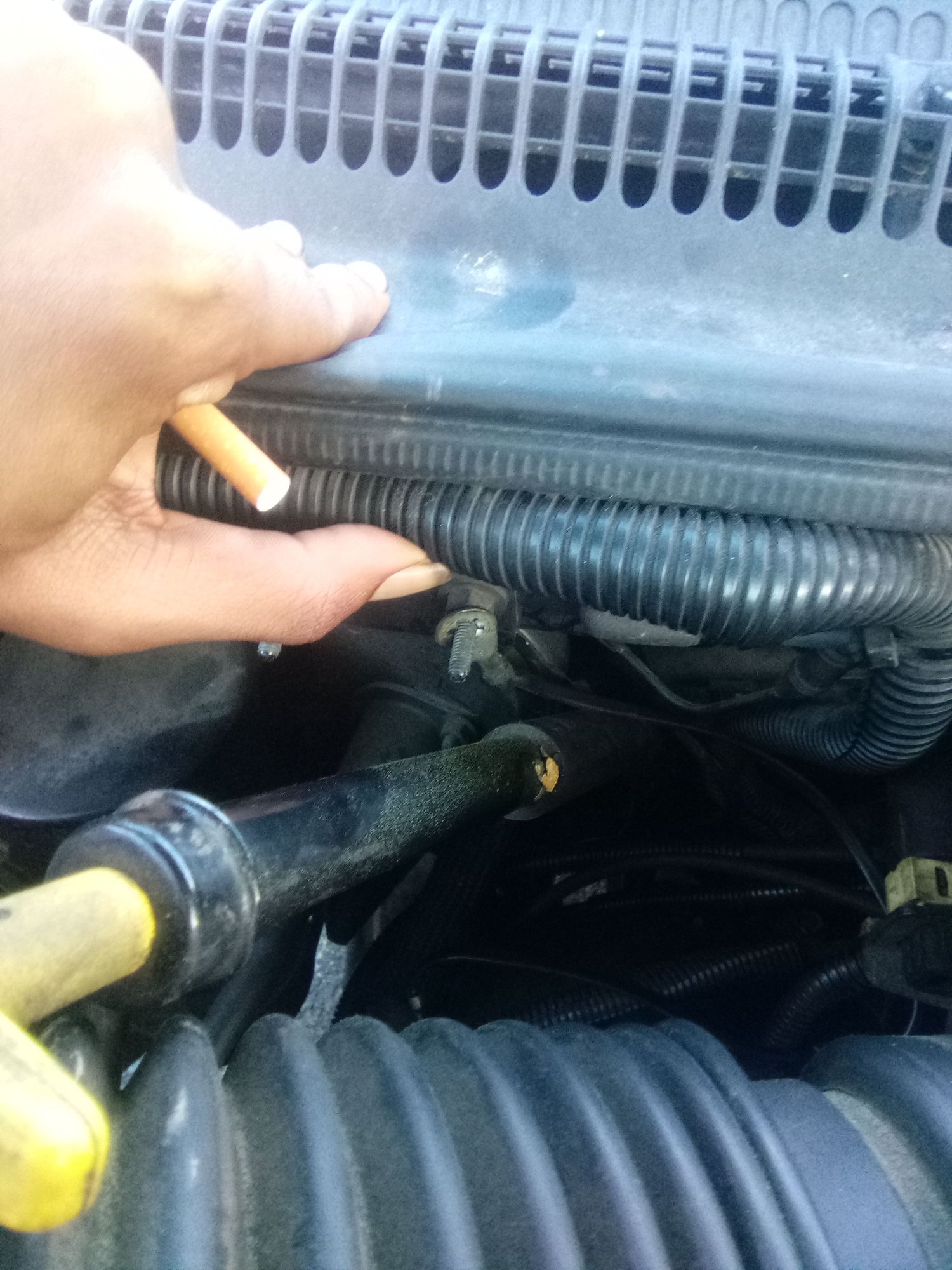

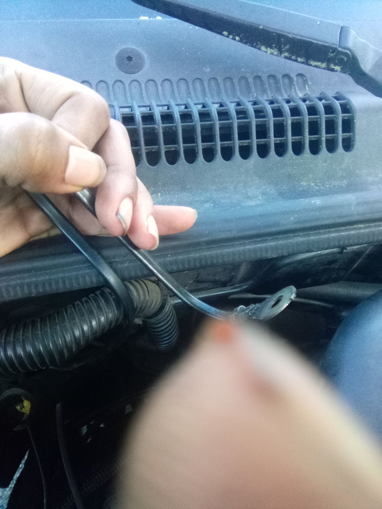

Just came back from replacing the Crankshaft position sensor and i noticed something very strange while i was replacing it.
there is a black wire hanging off a screw leg under the hood on the passenger side closest to the windshield there is no nut on the screw leg to hold this wire in place
also this same wire slips and runs down right above the top bolt of the crankshaft sensor. I thought the wire was grounded to the sensor but there is no way as the screw wouldnt fit in the hole of the wire.
i traced wires back and all are going back to the negative side of the🔋 so im assuming these are loose ground wires
but were does the one by the crankshaft sensor connect to or can i just tap it to the body?

That I don't know, but a picture of what you're looking at might help.

1st pic is wire on frame stud
2nd pic is wire I found hanging by camshaft position sensor

Engine ground strap I bet. Bolts to back of head somewhere. And yes, there should be a nut on the firewall end.

So I have checked and there is already a wire grounded to the back of the head but I was wondering if this one connects to the passenger fender
