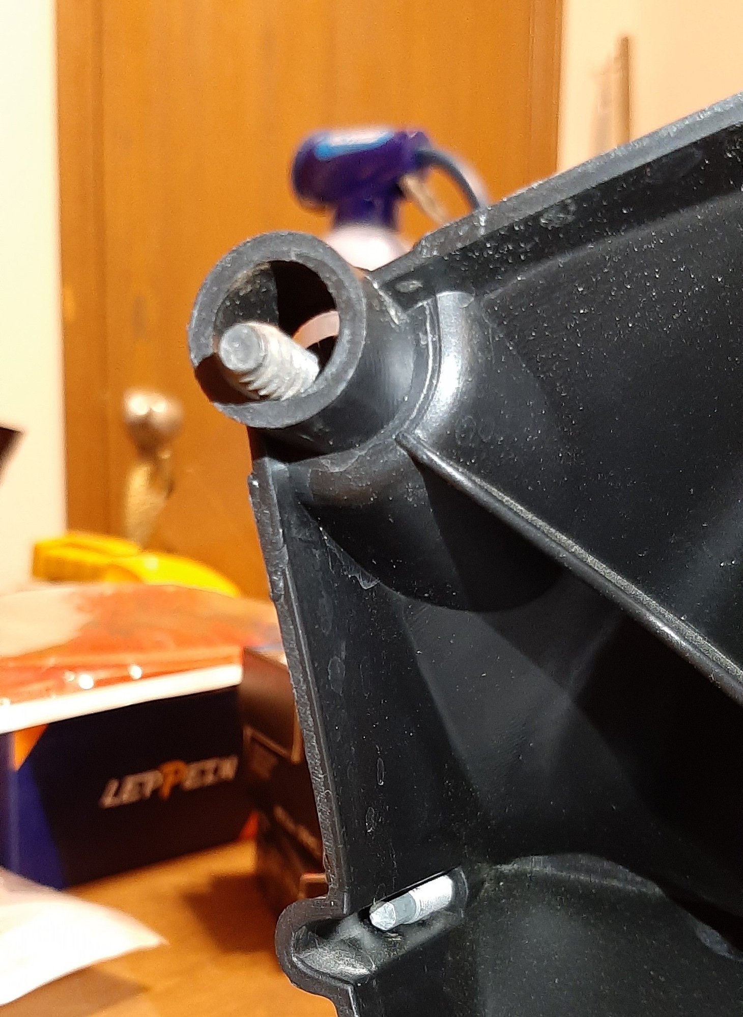

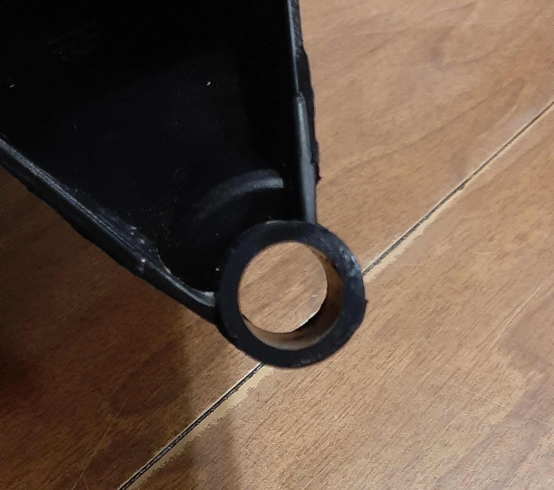

Headlight bracket mounting hole.
Has anyone else ran into this? What did you use to reduce the size of that hole?

Isn't there supposed to be an insert, or something, in there??

I hope so. I've not found much online yet, but the search goes on. The holes measure .530ish, I'll visiting a hardware store quite soon

maybe pvc pipe... hmm

Can you look at the original headlight, and see what that hole looks like on that one?

Find a nut that fits, then glue it in there with jb weld or something. Drill out the threads if necessary. Or...fill hole with JB weld alone, then center-drill.

That is how they are, its for adjustment of the headlight in relation to the fender and grille. My 03 was like that.
