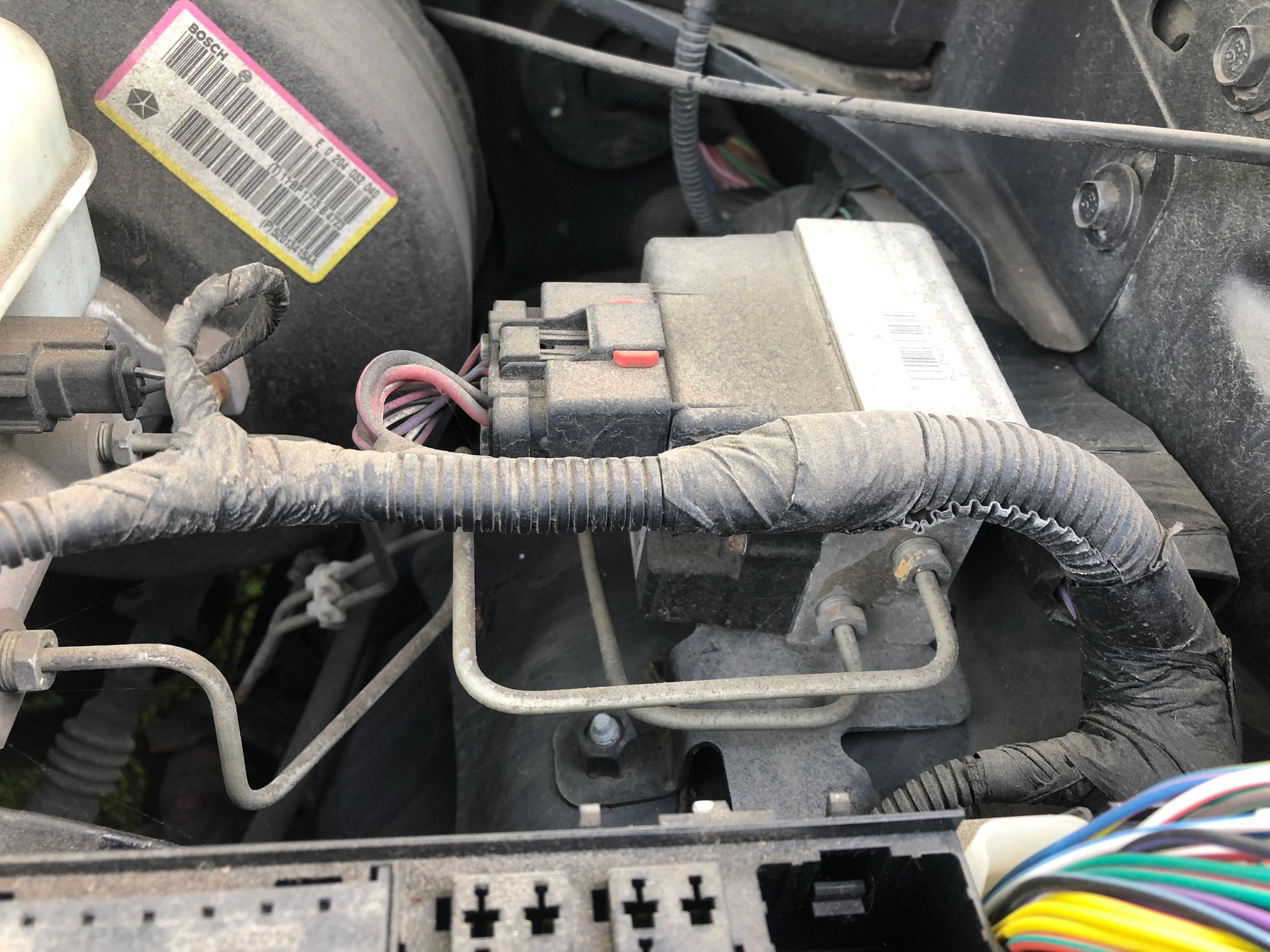

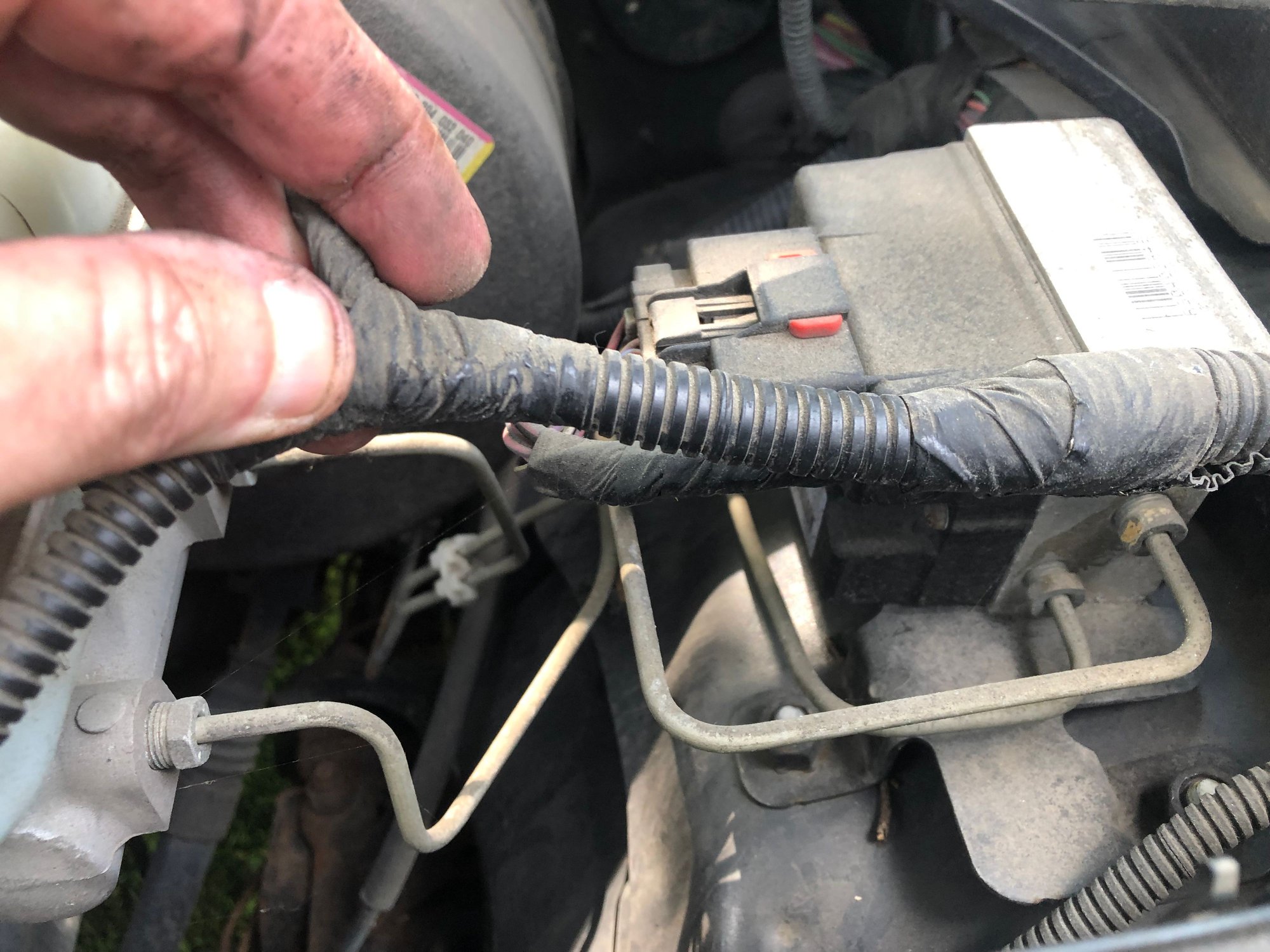

Well I think I found the motor control. It has one line going to master cylinder and one that takes off under the drivers side headin towards the back. I’m posting a pic
Old Jun 12, 2021 | 09:59 PM
Posts: 87,483
Only one line in/out? I suspect you just have RWAL...... Might try unplugging the electrical connector to that, and see how it behaves. (by doing so, it *should* just disable ABS, and hopefully leave the lights off.)

according to the vin decoder on this site, it says "Brake ABS System Four Wheel, Rear Wheel "
I posted a couple pics of what it looks like earlier in this post....the box has a brake line coming out of it and going to the master cylinder and another line going under the truck headin towards the back. I havent tried unplugging the abs control module to see if that help anything
Old Jul 2, 2021 | 06:27 PM
Posts: 87,483
I think that is just RWAL. (our vin decoder really isn't all that accurate.... try this place. Should cough up a build sheet for your truck, that tells you how it came equipped from the factory. Maybe it will be a touch more specific. )
Old Jul 2, 2021 | 07:15 PM
wizard6733's Avatar
wizard6733
Joined: Jul 2018
Posts: 65
well the link u posted says this "Pwr Disc/Drum Rr Anti-Lock Brakes"
Old Jul 3, 2021 | 08:57 AM
Posts: 87,483
Yeah, that is RWAL.
