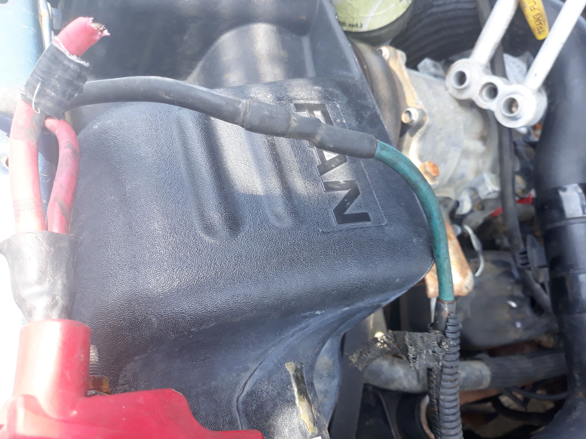

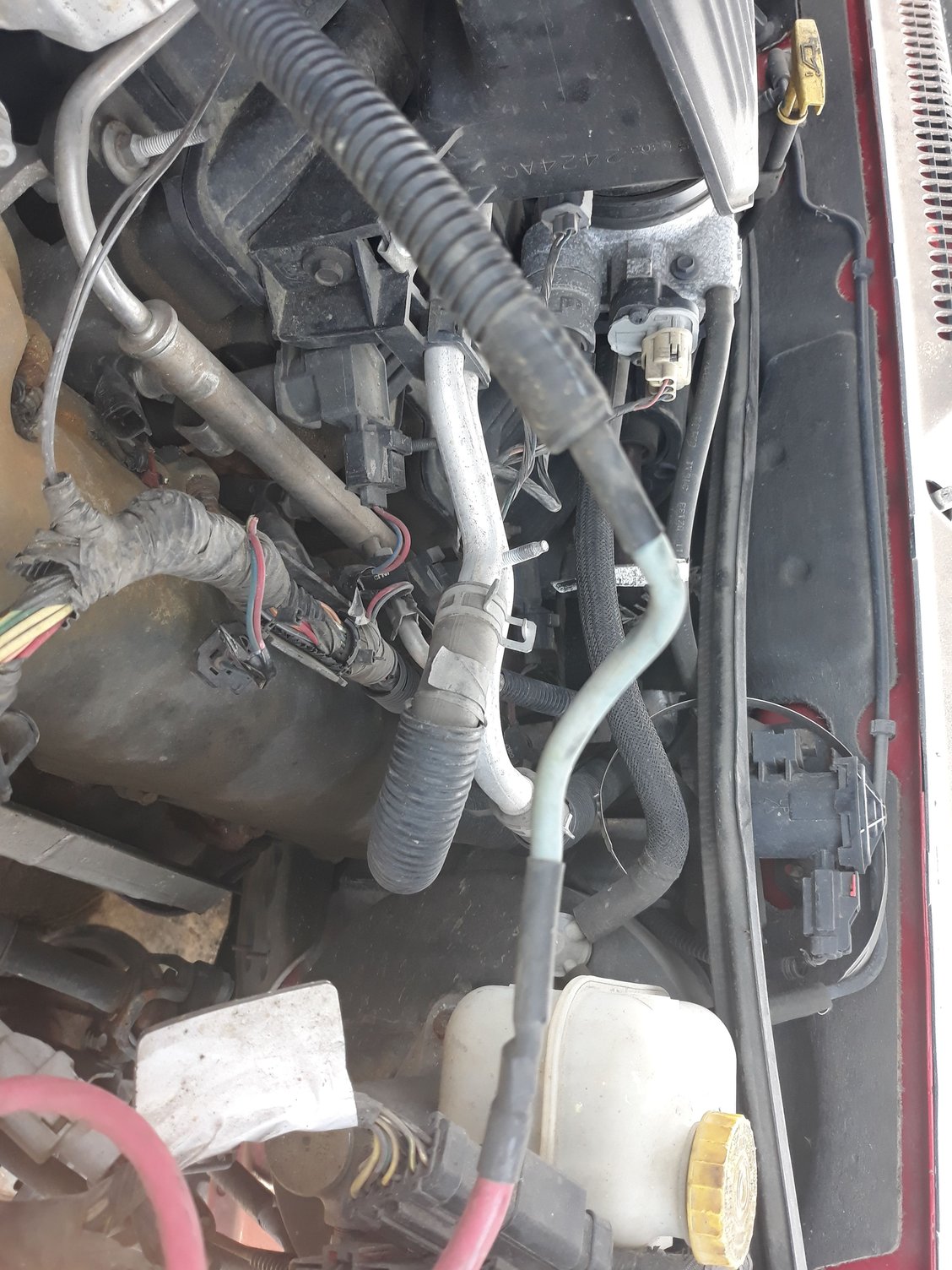

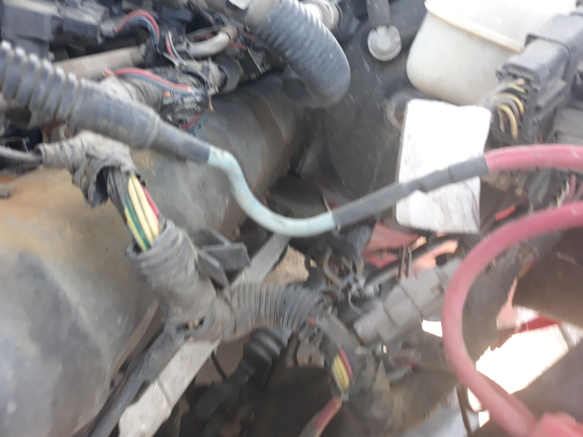

Is there any fusing in that wire that goes from tbe alternator to battery area.I see a lot of dakotas have a different wire attatched before battery like its fused ,Can that be a culprit also.
Pics show better
Looks like its on a lot of dakotas !
Not just a single straight wire..
I wanted to check all my grounds an that odd looking couple of wires .
[ These are from many other dakotas an mine is similar]
Gonna try that battery temp sensor soon too..
So far its doing great again ..after a lot of alternator test but i still dont trust it wont happen again at night when wipers are on an the system is more stressed.
Thanks
Old Jun 13, 2021 | 09:08 PM
Posts: 87,391
Likes: 4,213
That looks a lot like a fusible link......

That is a fusible link, and the nice thing about them is they're either working 100 percent, or they're open. When the fusible link gets over loaded the wire melts through.
I think I'd just replace the alternator with one that has an internal voltage regulator.
