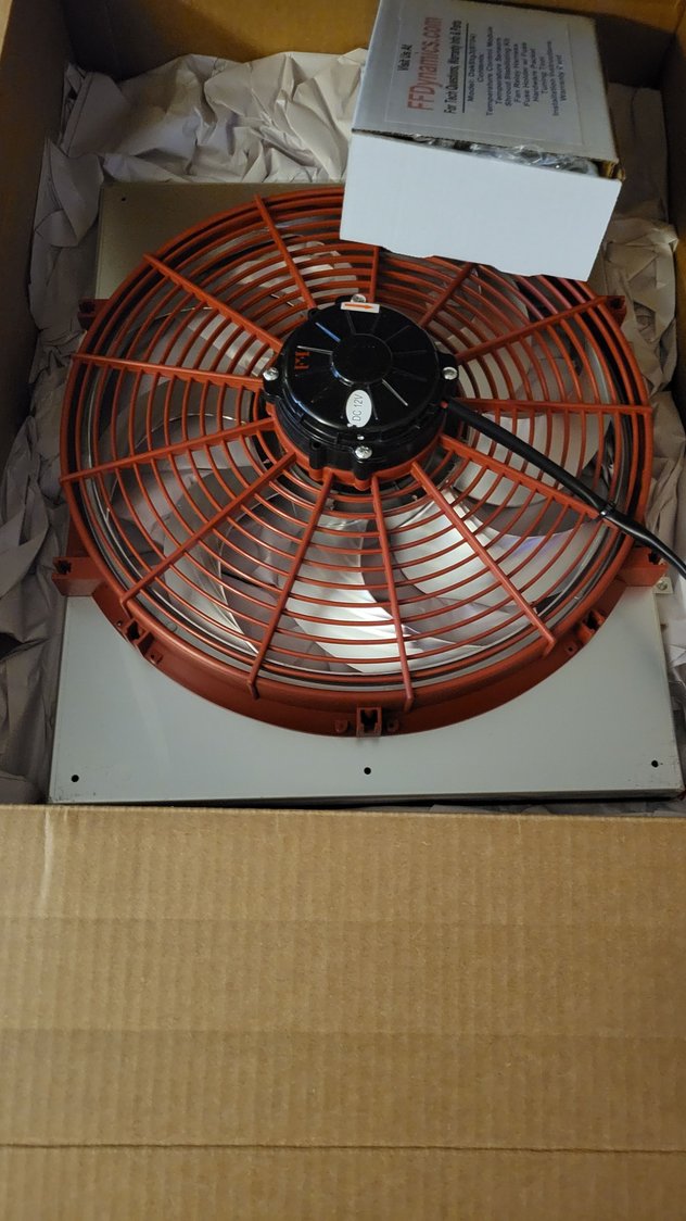

this is the fan that went in there. I'm also believing it could be the fan, magnethead above did say it should be enough and I have to admit FF dynamics was somewhat thorough when asking my intended purpose ect when i ordered. I also emailed them for their opinion.
Seeing as how others have had good luck with the ff dynamics fan and Magnet Head above saying it's as good or better than the Lincoln one many others have used makes me want to ensure the rest of the cooling system is doing its job and I'm not missing something, although I don't believe I am.. lol
Want to exhaust all possibilities before going back to clutch fan and writing off the several hundred spent on e-fans, the way the truck performs with the e-fan vs clutch is significant and would hate to go back enless I absolutely have too.

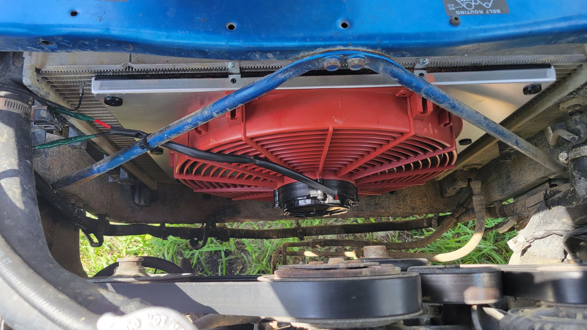

Have you verified that the fan is blowing in the correct direction? A fan blowing the wrong way would cool just fine when parked, and when vehicle speed forces more air through the radiator than the fan can force back, but at low speeds when the fan can overcome normal airflow it'll overheat. Simple enough to check, and it wouldn't be the first time someone wired them up backwards.
How are you controlling the fan? I don't see anything on the site on how they run the fan. It's possible the fan isn't getting full power.
Also, is the fan shroud sealed against the radiator? Air, like electricity, will follow the path of least resistance. It's easier to draw air through a large side gap than through the thin grid of a radiator. Likewise, if there's not enough space between the back of the radiator and the shroud, the shroud may actually be blocking off a large part of the radiator. I like to see 2 inches between the back of the radiator and the front of the shroud.

Came with a relay and fan controller with adjustable temperature settings. I believe only 1 strength, wired directly to battery power with a key ignition fuse to ensure only running when key is in. Starts at temp I set, and when AC is engaged.
Has a partial shroud, I was concerned it wasn't a full shroud b4 I ordered, this was their response "It will be built 16x20, so the top 16" of rad covered, leaving approx 2 1/2" on the bottom open and approx 1 3/4" on each side open. This leaves enough rad exposed so that natural airflow can pass around our system and through the radiator at speeds over 25mph.

The shroud itself is aluminum with a rubber type seal around the edges to seal the shroud against the rad.
I'd say there is about 2inches from the rad to the fan, give or take half an inch.
