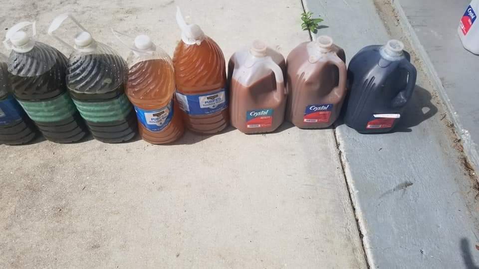

Attached are the pics I took of samples of the coolant color through my process of around 20 flushes. I did it until I got clear coolant back after 1hr+ long runs. Used some cleaners to assist in getting crap outta the system too. This was done with the old rad still in place to make sure I didnt jam up the new one. After getting all clear & clean fluids I pulled the rad, installed new one and did one last flush which all looked good and clean.
I had an issue before with air in the coolant system due to a bad reservoir tank leaking which is what started this whole endeavor.
Also, likely unrelated, but I also replaced the intake manifold with the edelbrock hughes gap manifold, the result of a snapped bolt in my old keg manifold when doing a tstat replacement. :/ lol
