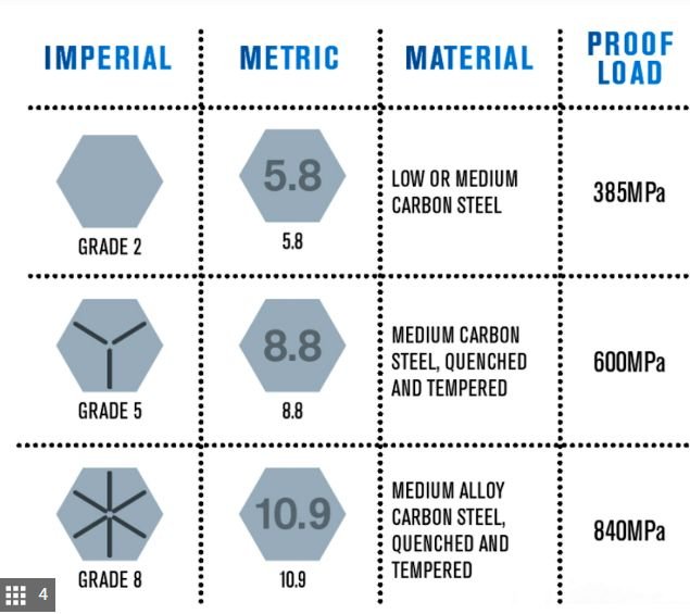

for a valve cover you only need grade 5 8 is over kill if metric use the equivalent.

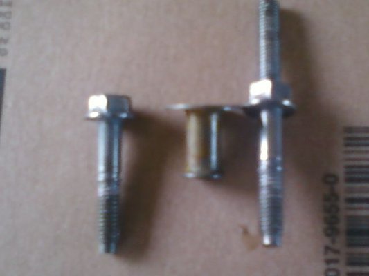

I'd visit a junkyard. You may find some in screw bins, but not all. I recall some of the valve cover bolts having differences based on location for the 4.7L Some were studs and some were longer than others, etc. I had to mark the valve cover to make sure I put them back in the right order.
