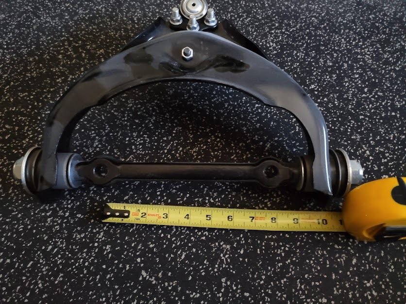

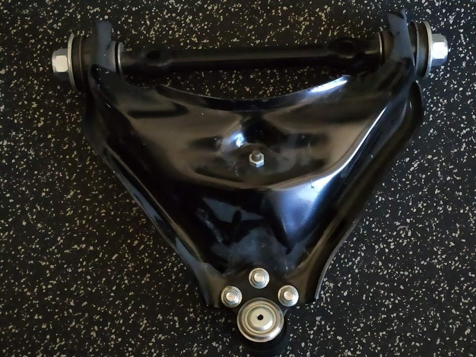

these pic's may help 2000 2WD control arm upper looks like 7.75" between the mounting holes.

That's why I have a set of 2000 upper control arms I'm going to do the brake swap I have a set of good 2000 spindles new upper and lower control arms with all new calipers and pads. basically I'm replacing the front end completely.
Just haven't had the time to get it done.
