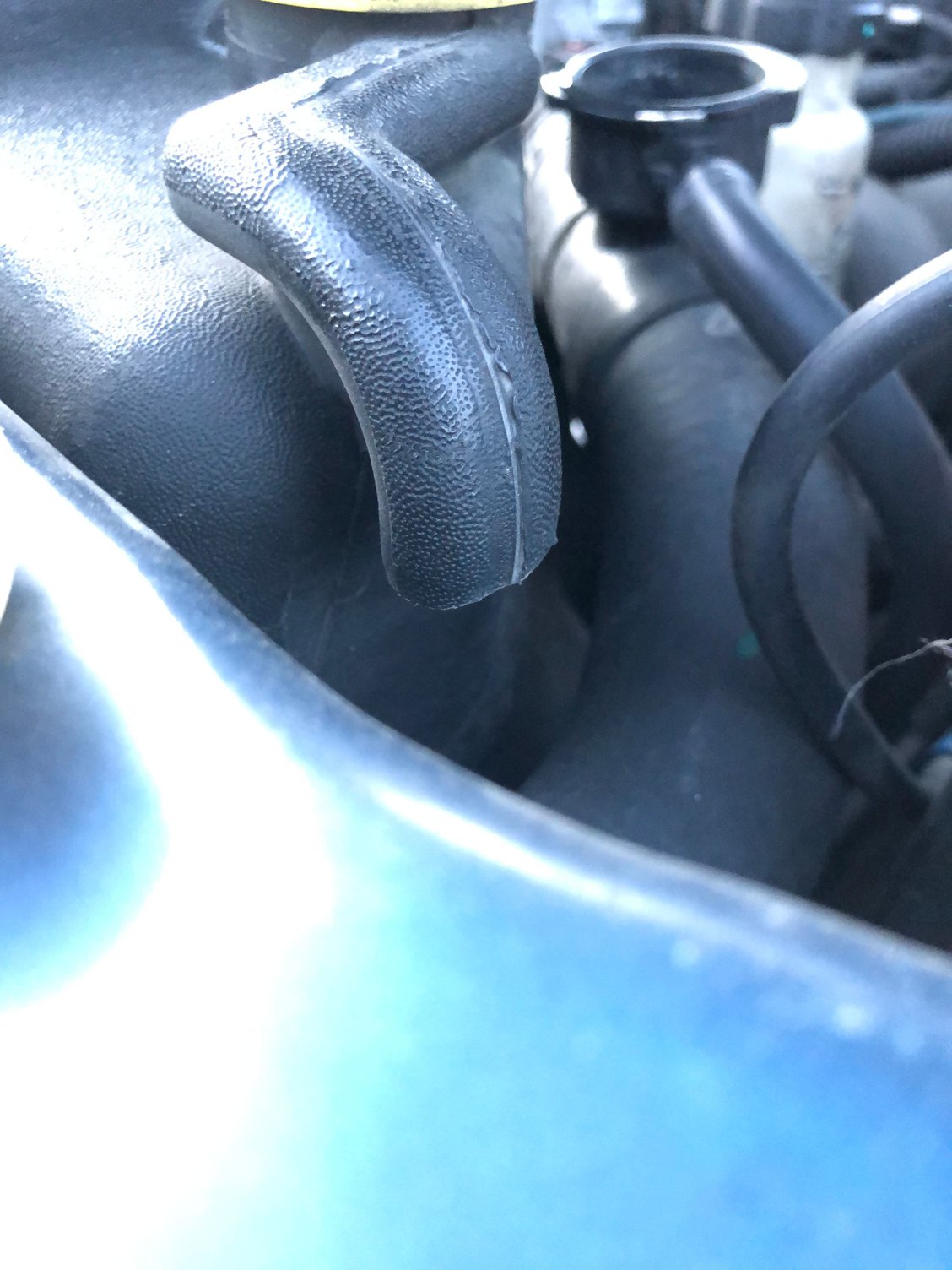

This is the top of the radiator - driver side - coming from the reservoir - that pipe doesn’t have any hose connected to it, I’m guessing that’s not normal? Lol

Your pic shows the coolant expansion tank. It is vented, so that's normal. No hose.
