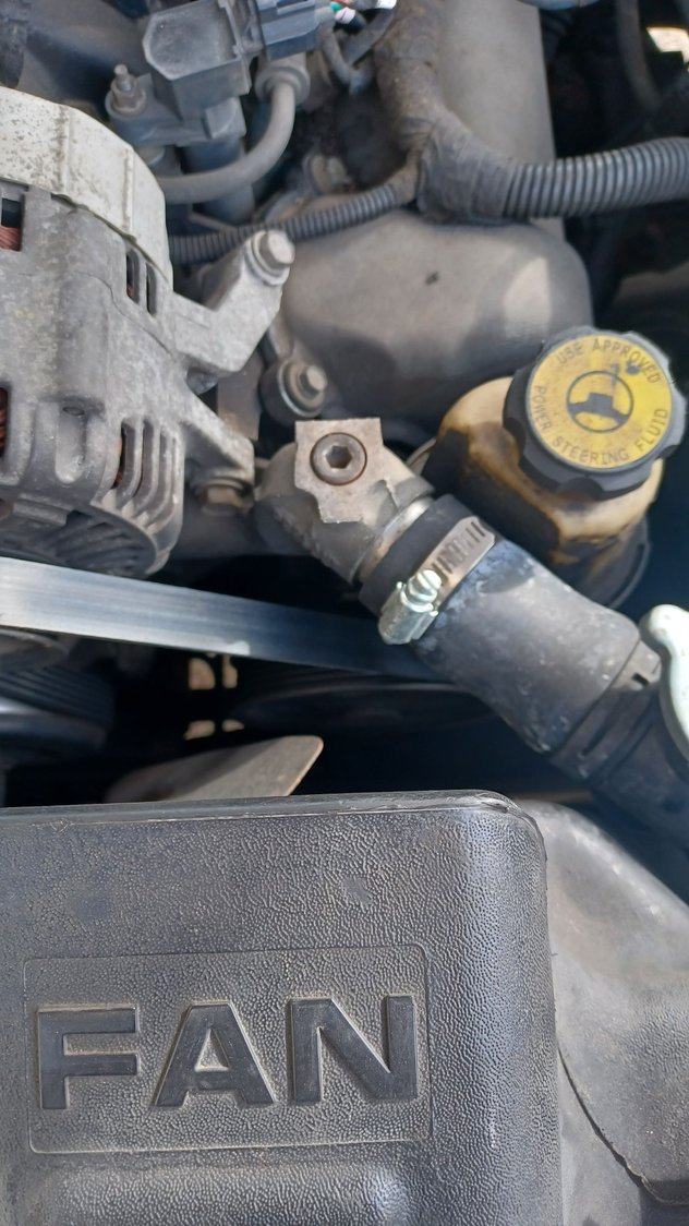

I had similar problems with over heating as you described. After extensive troubleshooting, it turned out to be air gaps in the coolant system. The cooling system needs to be void of all air.
There is a bleed off plug located where the top radiator hose goes into the top of the motor. Before tearing things apart, I would 1st try bleeding the air out by removing the top pressure cap on the hose, and then the bleeding off plug, then with the engine running let the coolant circulate and adding coolant as needed until there is no more air bubbles in the system. Then replacing both the pressure cap and bleeding plug.
Jacking up the front end or driving it up on ramps, makes this a much easier process. Air bubbles rise and if the front is lower than the rear, the air never leaves.
