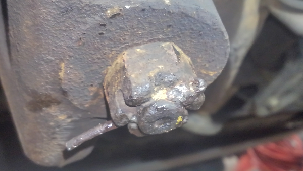

Why... Just why... such an easy swap made so difficult by a-holes taking shortcuts.
Looks like someone put epoxy on the bolt, I got 2 options, 1) cut it off or 2) try to knock as much of the epoxy off the pin as I can then use the impact driver on the bolt. Either way I get to stop for at least 90 minutes for a meeting, then either dive back into it to try and chip away at it to free the pin or go to store for a sawzall blade that is up to the task... I do need to get a ball joint press, so I have to go out anyways.

Grinder with a cutoff wheel... pavement sucks thread suggestion, did not think of that
That looks like just a bunch of mud and rust building up. A heavy duty ratchet and cheater pipe MAY get it loose. Penetrant is a definite need there. I have a really large nut splitter if the cheater wont do the trick.

It was not mud & rust... I think it was that steel epoxy. When I hit it with the grinder it cut thru it like it was epoxy. It took less than 5 minutes to get off with the grinder cutting that crap & the cotter pin off, then putting a wrench on it.
