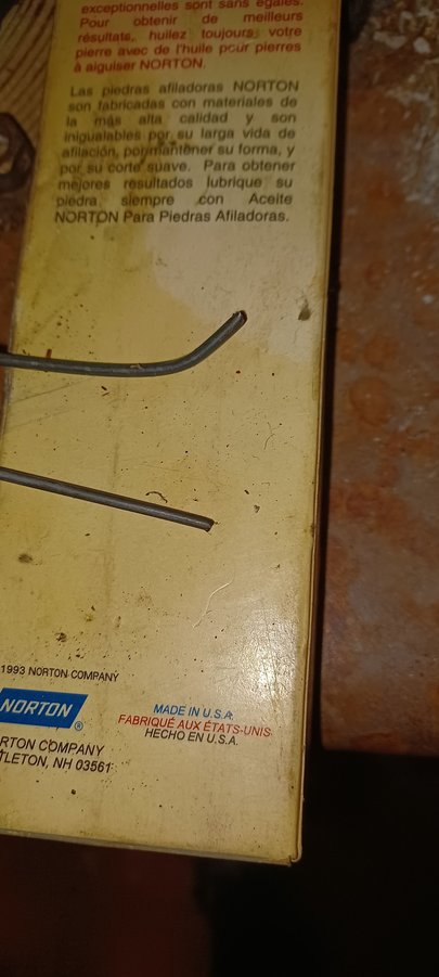

Had retorked that balancer[ with impact on last 40lbs for the 180ft ,but could be more ] an had to turn it a time or 2 to get it back to TDC- seemed a bit tight. I used that dowel in the #1 plug hole to see where TDC was an at about last small turn after about 2 turns at crank i got it rotated to the TDC / #1.-.but i then couldnt get dowel out..i turned cam counter clockwise a bit an was able to get it out but a 30 degree bend [ likely happened at last tdc turn at top but not sure]
Nothing broke just a bend..see pic..
