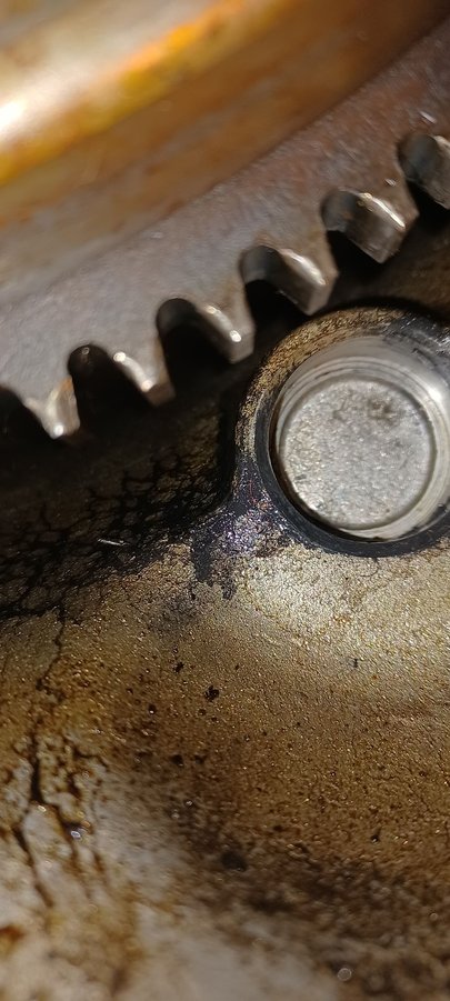

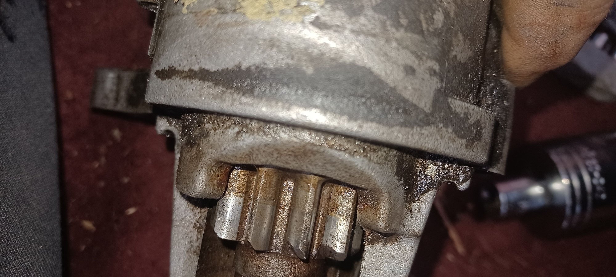

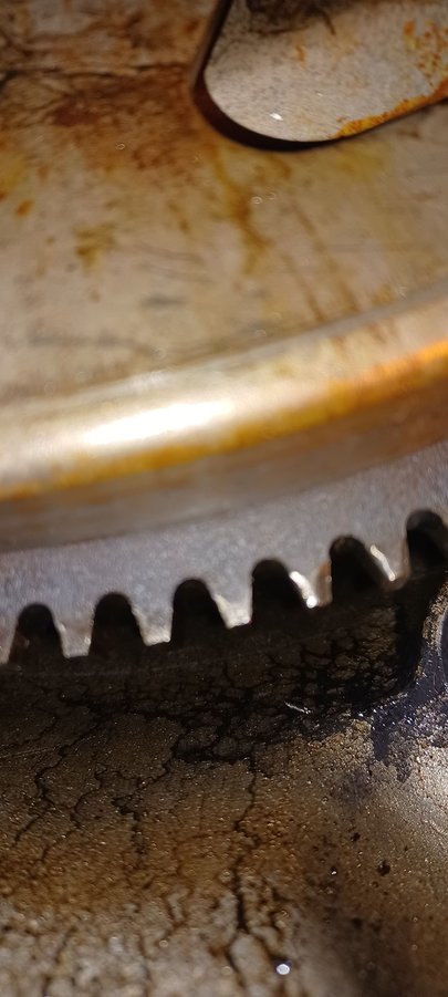

Took off the starter an flywheel cover to see the teeth.. .I turned the crank in order to see it all.I didnt find any teeth off
Does that look pretty normal on the wear on it an starter that i replaced.

yea that's about normal for a high mileage stock ring gear. Knocked a few corners off the ring gear but not bad. Starter gear is intentionally tapered. We've broken our fair share of ring gears over the years, so it's worth checking.
Forgot yours is a 3.9, the double-notched tone ring points that out.
The factory splash shield was one of the first things I took off and never reinstalled.
So now you can focus on the issue with the other noises you have going on.

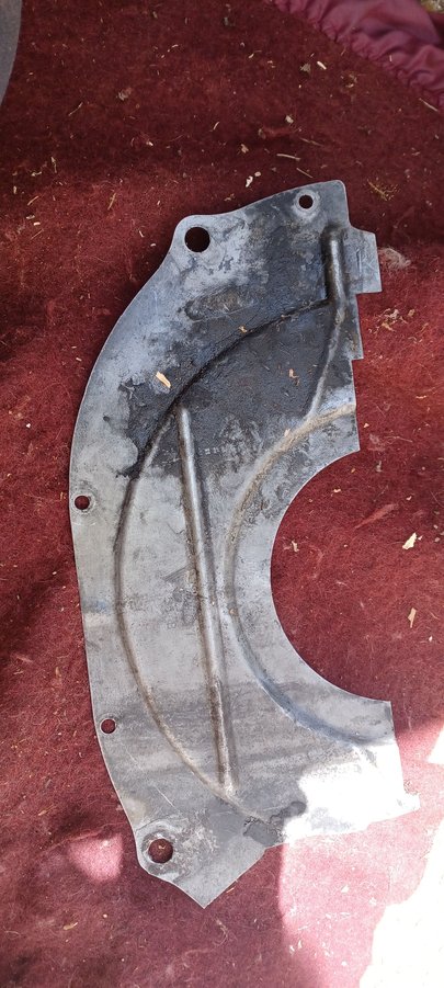

Bingo!!
That cover plate -- I left it off after inspection, an turning crank back to TDC ..an after putting starter bk on tight an without that plate in--It started right up! No weird noises.
Ill know more tommorow when i let it idle an do a few checks for leaks.
Is that aluminum guard acting like a shim .?
Tempted to cut that starter part off of it or replace it.
..i put the darn cover bk on with side cut an it made that crazzy sound again.. ..gonna have to either get one off another dodge or fabricate one !

Thanks. Thats good to know...i fabricated a piece using trim coil aluminum [ easy an tough ].
Tried same part off another dakota an same thing .. scrape noise.

I left that darn bell housing cover off. LIKE U SAID.... I even
realigned the tranny with the engine an overdrive bracket an it mounted more inline --- an ran good w no noise now.. Those flywheel bolts were hitting it..At least all the engine issues are resolved with the new timing chain,water pump ,balancer,crank seal ,dreaded oil pan gasket, an starter!
