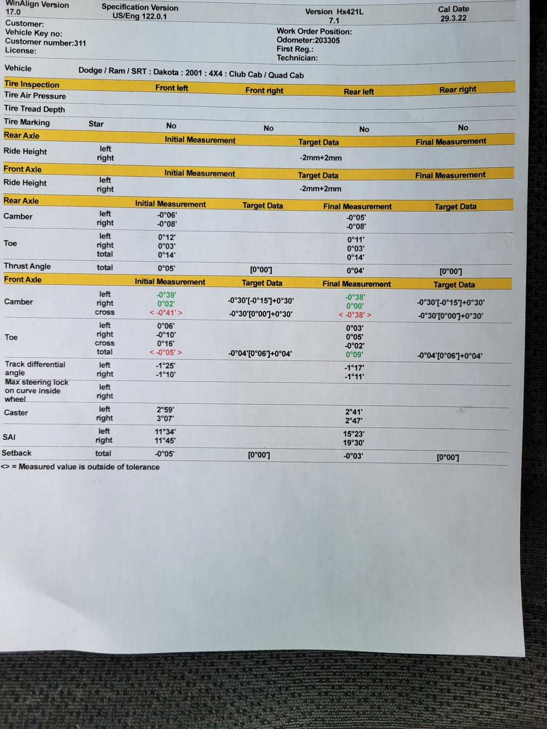

Had it realigned today i will include the results sheet.
Question is i need ideas as to why its pulling hard right again...

Just to make sure I understand, after getting the ride height level on both sides the passenger tire has too much camber correct? Or is it both sides? If its only one side I would pull the passenger lower control arm and check for any bends. Also double check the bushings. If they aren't seated 100% you can get some wonky alignment. If its both sides I would look into whether the parts are correct or have some incompatibility. MOOG has a reputation for claiming "factory replacement" while also making changes to the design. Sometimes these changes are not compatible. On my escape I had to grind away part of the sway bar linkage because MOOG added extra metal where the factory one was thin.
Just the drivers side has too much camber. And its pulling right

Does it pull to the right all the time, or just when you brake? Have you lifted the front and spun the wheels? Are front rotor temps about the same or is one hotter than the other after a drive.
Pull is constant. All rotating parts in front end are brand new (ie less than 2000 mile) fluids inner and outer half shafts hubs and rotors. Its not in the brake system as every bit of it is brand new as well all done at the same time. There is no play in the ball joints or tie rod ends. Visibly i see nothing bent. Per the response above yours the frame is straight and dimensional correct to factory specs. My next option from everything i can see is new upper and lower control arms. 2 alignment shops same return. Ant the frame shop says the frame is straight.
