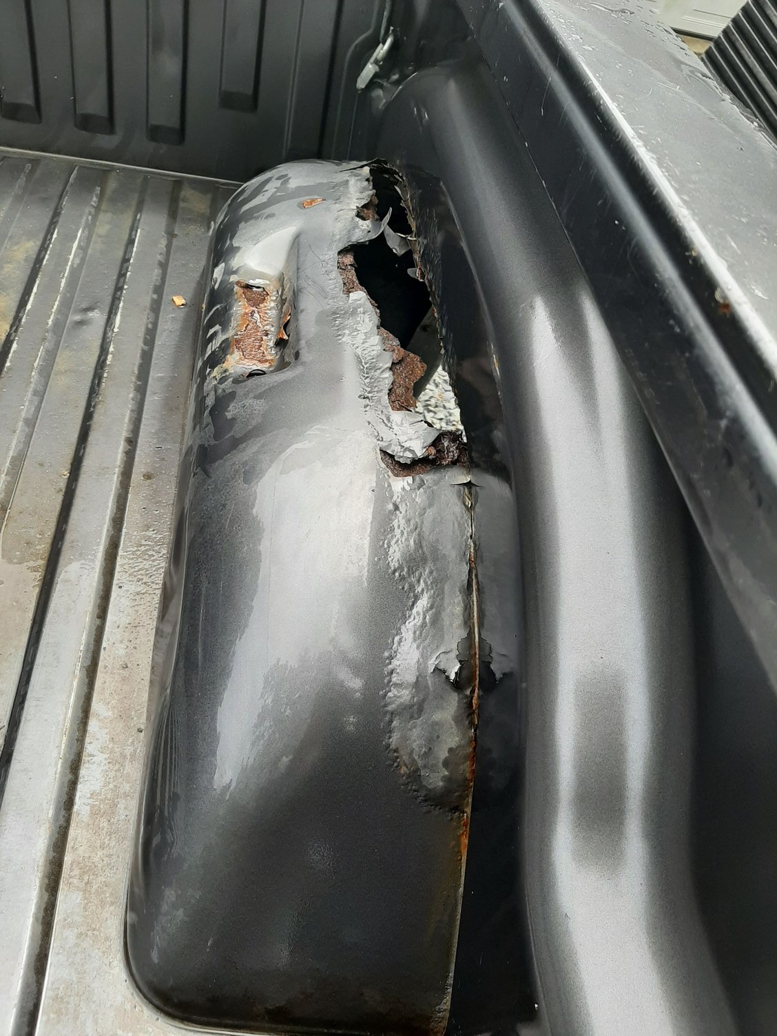

I have an 03 crewcab 4x4 with 4.7. I just removed my bed liner to find significant rust around the tops of both wells. Question is, I'm sure im not the first, so does someone have a successful repair process? Im looking for another bed but thats turning out to be difficult. I would rather do a repair as good as possible. the sidewalls seem solid, but if I start grinding I may find more.

Cut it out and replace with new sheet metal.

So, just cut it away to get to clean metal and then use sheetmetal to patch it and do some bondo smooth over?

May be able to find repair panels too for that matter. Check out LMC truck.

I've seen rust in the bed under a liner, but never that bad. If you're good at welding and fabrication, patch it. Otherwise I'd find a southern bed without any rust. By the time you cut all the rust, including what you find while you're cutting, there may not be much left to patch.

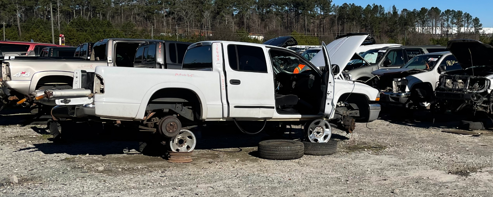

Dear Electrocoating, I introduce to you, SALT!....
Seriously, I know gas prices are high, but if you happen to be taking a trip down South, I see beds without a spec of rust on them in the Atlanta U-pull-its all the time.
Example: I took this a few months back when was searching for a seat cushion.
