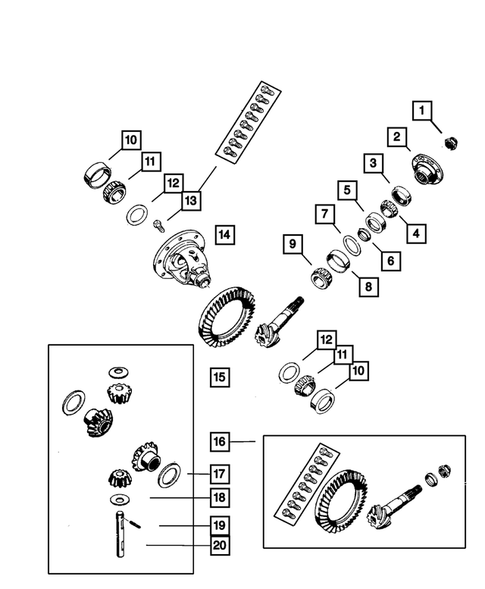

Is it making a ticking noise at all? Does it change with vehicle speed? Does it change if its in 4 low vs 4 high? It's probably the Pinion bearing on the front differential.
#9 and #4.
