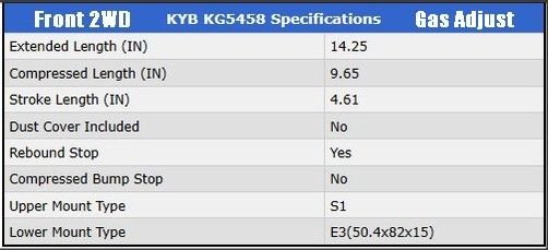

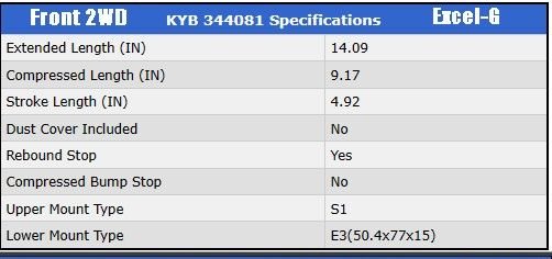

1. How do I measure the truck for the correct shock length? On the ground with shock removed, in the air with front end extended and shock removed, in the air front end extended and shock still installed?
2.With different lenths for extended, compressed and stroke on different shocks (only slightly different) I went with longer stroke length initially thinking they wouldn't top out or bottom out.
Do I have this backwards? Buying shocks didn't used to be this hard. Maybe it's a Dodge thing. Just kidding, tho' this is my first Dodge.
Appreciate the help
Example of what I'm looking at below

Manufacturers should have recommendations for your specific application.... You don't want the shocks to be what limits suspension travel, and you don't want them to be acting as bump stops either.... So, measuring from eye to eye with suspension fully compressed, and then, fully extended, will give you an idea of what specs you are looking for. Of course, trying to get that fully compressed measurement is gonna be fun.....
Looking at your specs there though, I am rather curious why the shorter shock has a longer stroke length..... that seems kinda counter-intuitive to me.

Thanks and I agree that MFGs give correct recommendations. The disparity in stroke length might be due to one being a gas shock.

to me measure your bolt to bolt (on the front lower bolt to frame hole) distance on an at rest suspension, and you want the measurement to be roughly in the center of your stoke specs. In the example provided I don't see 1/2" making a hill of beans difference as far as failure is concerned
edit: could always jack the vehicle off the frame and see what your hanging suspension measurement is, if that's getting close to the max stroke length it would be reason for concern
