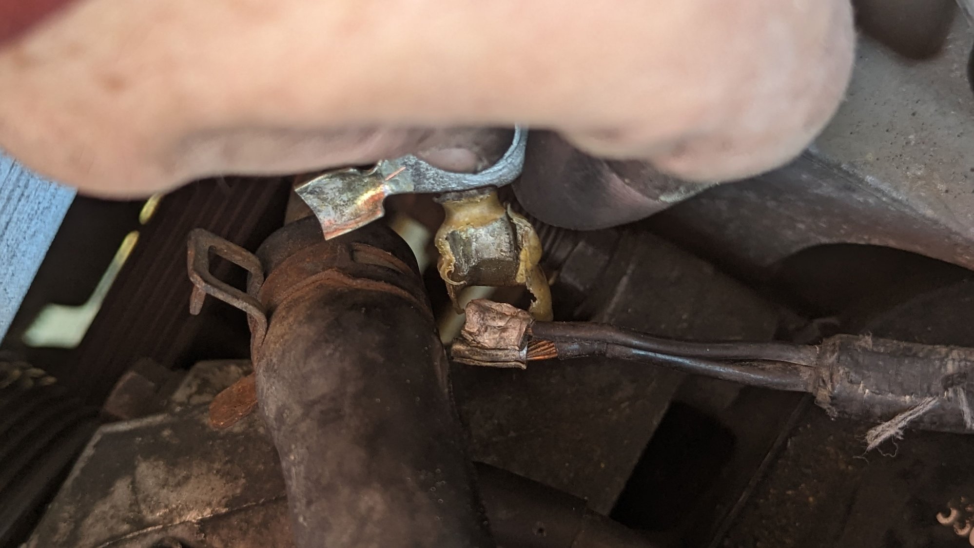

The truck is finally running and I feel confident that I have identified the fuel and the electrical problems. It's kind of tough having two at once. Anyway, the fuel issue was definitely the pump. The electrical issue was a grounding problem, common enough on these vehicles.
The problem was staring me right in the face. I managed to get the truck running a couple of times today, but then it would shut down and the ASD relay would chatter. I started going back through the electrical system, particularly the grounding, because I was still reading 10.5 VDC on the ground pin of the ASD relay, meaning the PCM couldn't pull the relay to ground to give enough voltage/current to hold the relay.
It was starting to cool off and get dark and I had already gone through all of the ground connections, reseating several. Finally, while trying to think, I just started wiggling ground wires and as soon as I got to these, the chattering stopped, then started again. I wiggled them again, the chattering stopped, I started the truck, the relay started chattering and the truck died. I had found my problem.
You see, I had given this truck to my parents to use for about three years and they had some problems with it, similar to mine. Their mechanics replaced the PCM, installed a new battery terminal clamp, like the ones you get from Autozone that clamp on the bare wires. Those are meant to be temporary. I had replaced that several years ago when the truck was acting up. Well, I didn't think that they may have replaced some of the other factory connectors, trying to solve a ground problem just like me. This is what I found. I have made a temporary repair until I can get some good connectors and solder them up. One of these conductors is the PCM ground. I have the 5.2 engine and these are grounded to the alternator bracket at the front of the engine, battery side.
