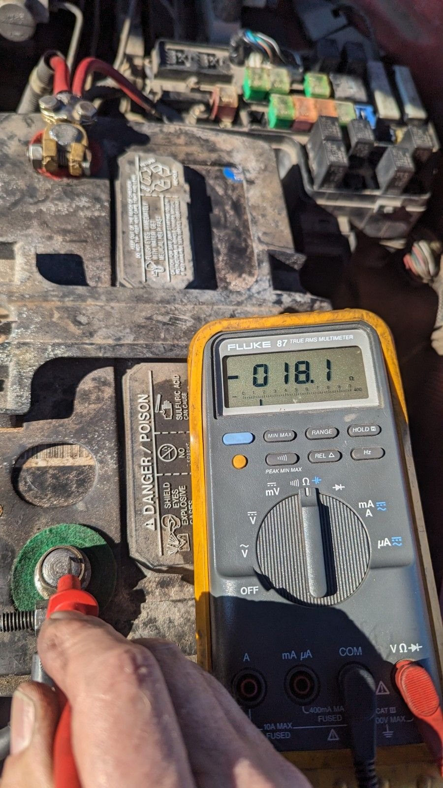

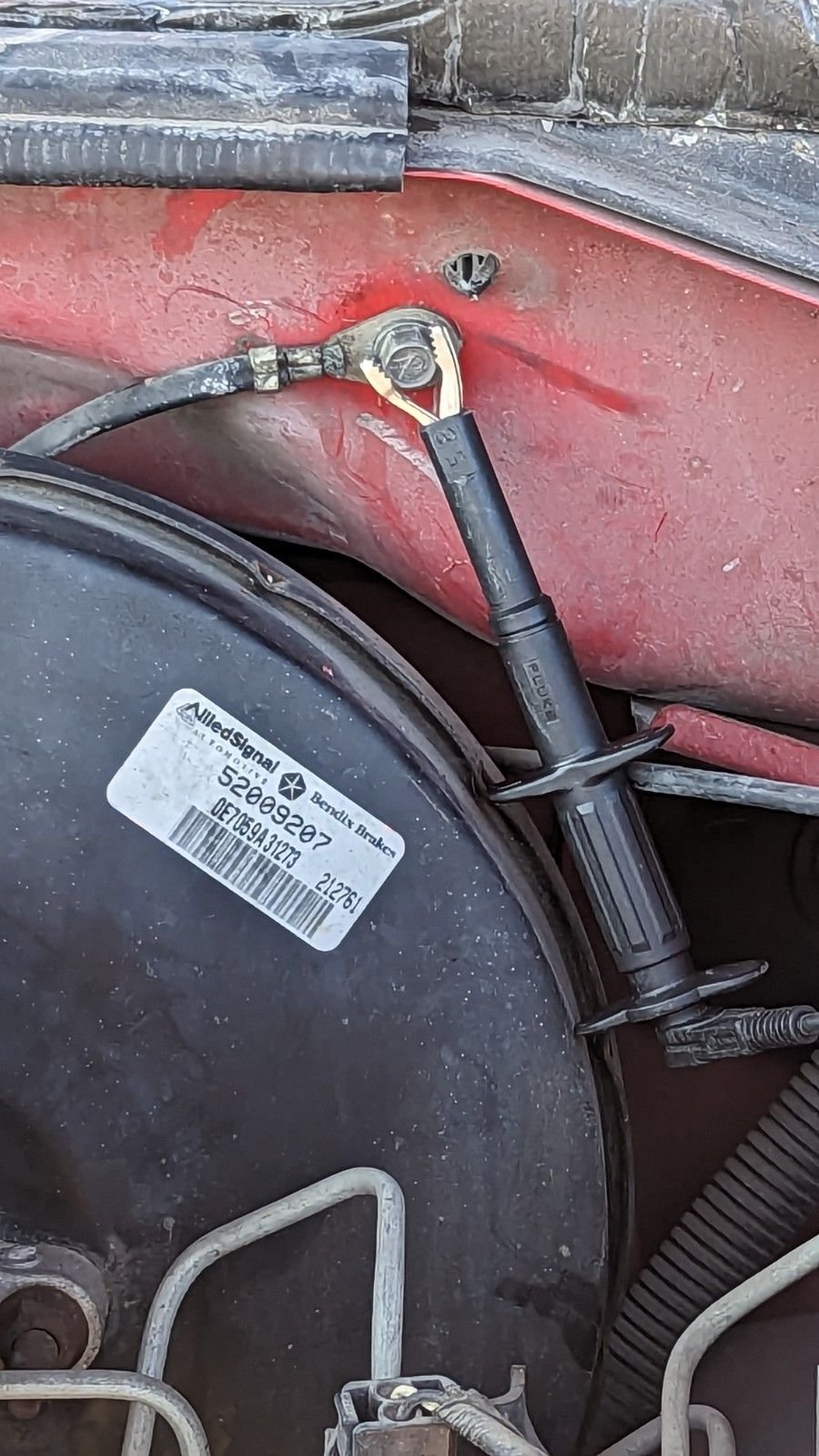

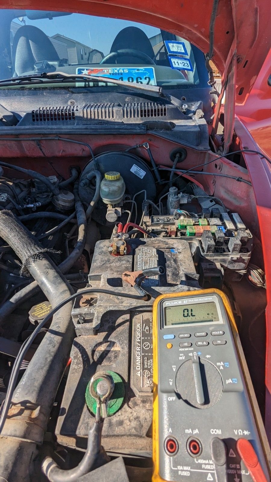

Something else. I have been cleaning all my grounding points and have been checking them to the negative terminal. Having the battery positive connected is throwing off the readings - I did not know this but will remember. Here are some pics:
Cab Ground
Unexpected DCR wtih battery in circuit
Remove negative lead
Removed positive lead expected DCR
Removed negative lead expected DCR at terminal clamp

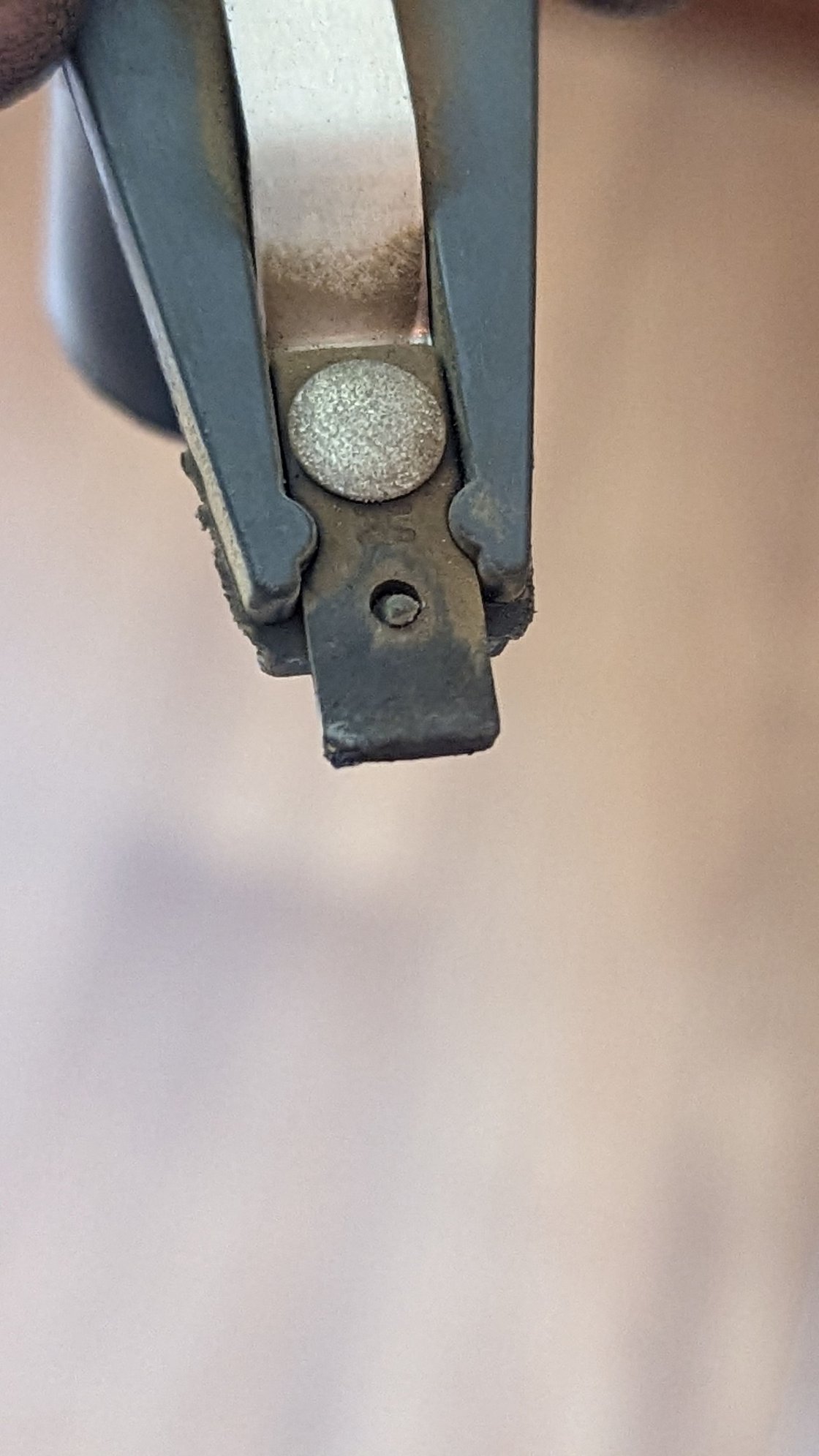

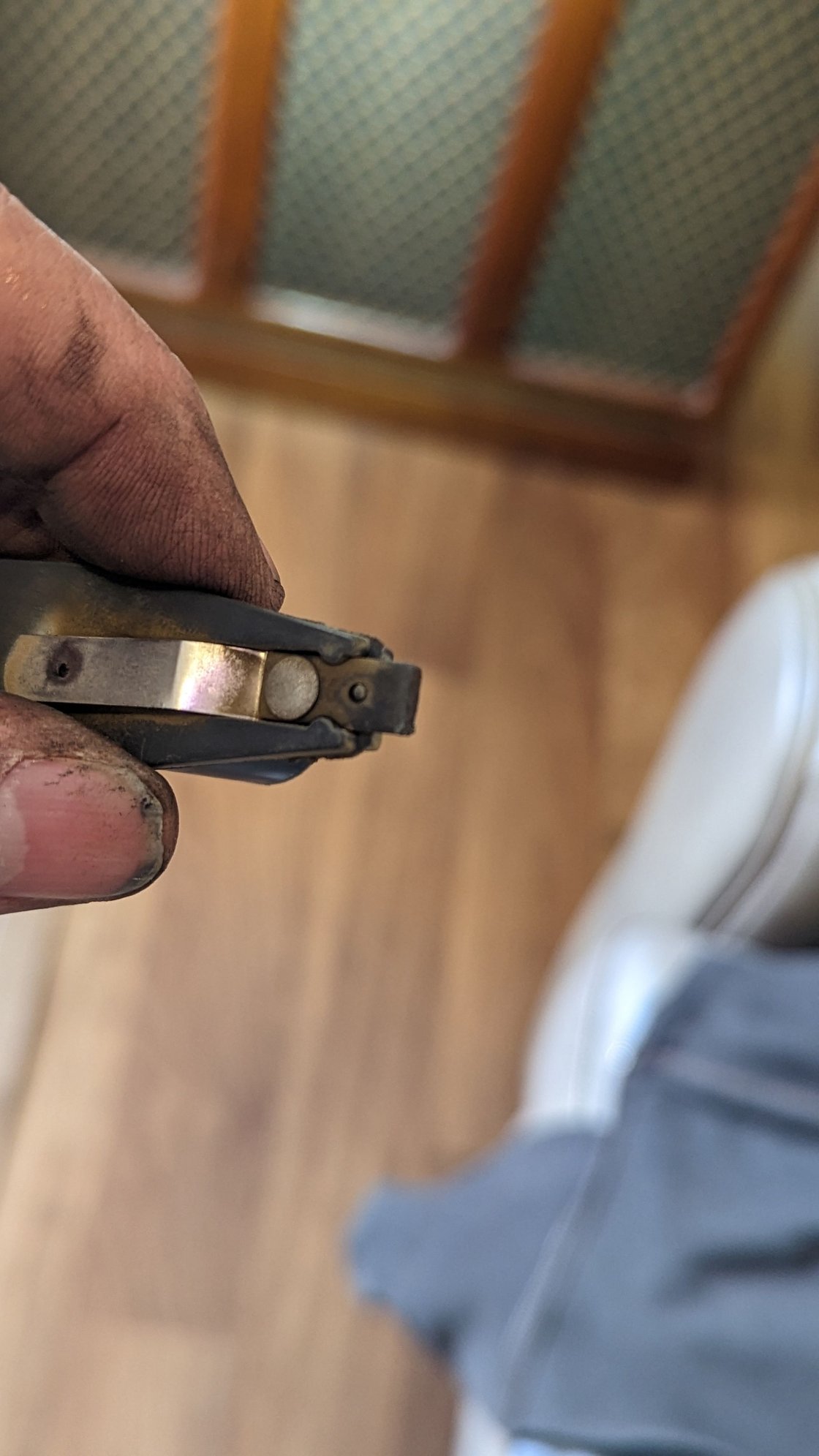

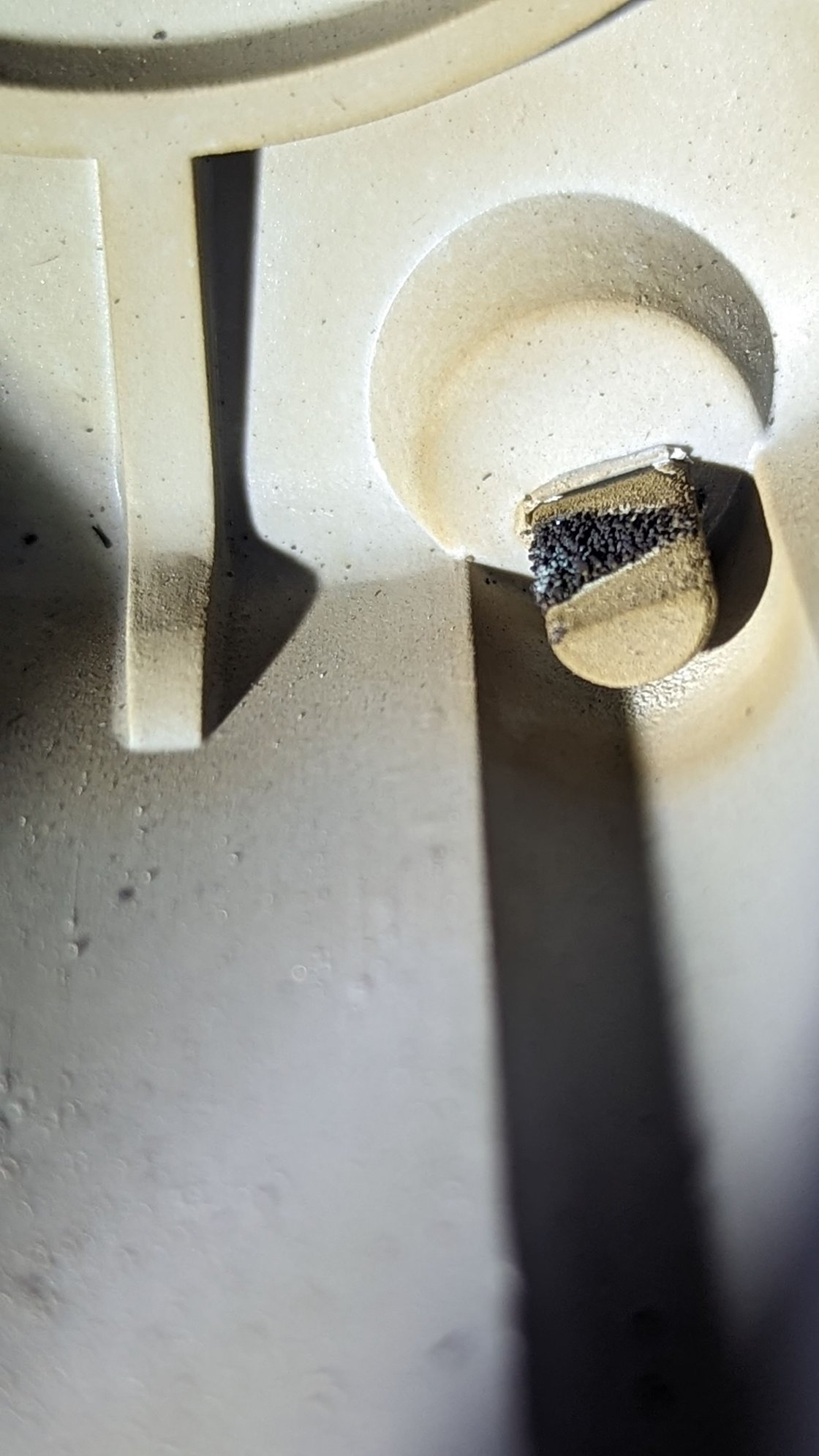

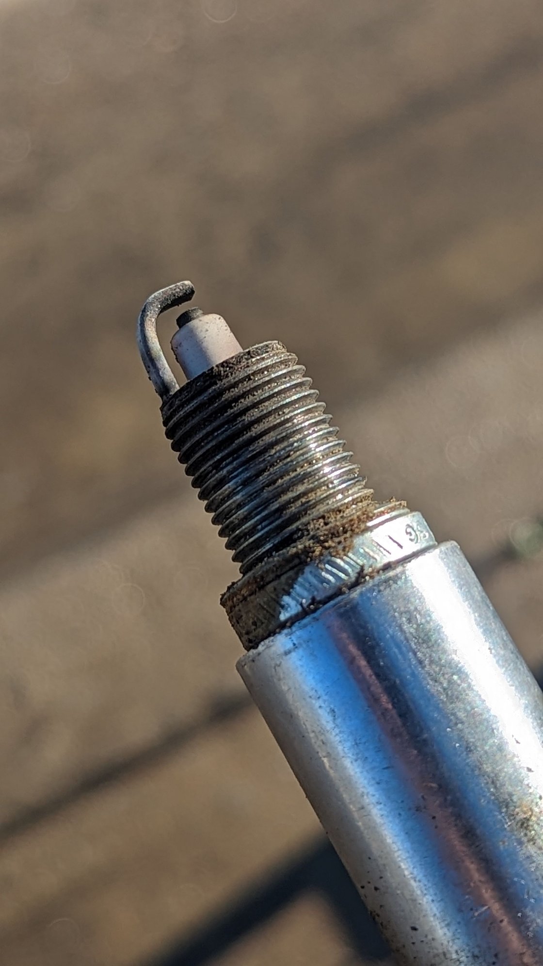

Here are the spark distribution components. I pulled one plug, it looks good. The rotor looks pretty good. The distributor cap shows the most age, but the arcing has been even across all of the poles. I will clean the faces and put the parts back together.
Distributor, signs of arcing, most of material still in place
Good Plug, only pulled one

After charging the battery until the charger read 0 amps, I turned on the key and the ASD relay is still chattering. Not much point in cranking the motor until I can get that sorted. Here are my thoughts:
  1. The battery could easily have a problem, given it's time in the heat. I will perform a load test as best I can and see how low the voltage goes when I crank the truck.
  2. Why is the DCR reading so different on the negative terminal with the battery in the circuit? Is this affecting reference to ground for the ECU?
  3. I will measure control voltage at the ASD socket across the relay control connections, both with the socket empty and with the relay in place
  4. I will measure control voltage at the the ASD socket from each of the relay control connections to ground, both with the socket empty and with the relay in place.
Old Feb 3, 2023 | 09:03 PM
Posts: 87,483
Your meter measures resistance by passing a known voltage thru whatever wires you are testing, and seeing what the return voltage is. With the battery hooked up, it's possible that is throwing the return voltage off. But, I would expect that only if there was a short somewhere, and there was battery voltage on the wire you were testing. Might not hurt to set your meter to 20 volts, and test a few spots.....
Old Feb 3, 2023 | 09:29 PM
tensleep's Avatar
tensleep
Joined: May 2015
Posts: 50
From: DFW Metroplex
I was thinking along these lines. That's why I'm going to make all those measurements tomorrow that I mentioned in my prior post. If there's a short somewhere and it's causing the chassis have a different potential to ground , then it's very possible the PCM has lost its reference as well and that could be what is causing the related chatter on the relay.
