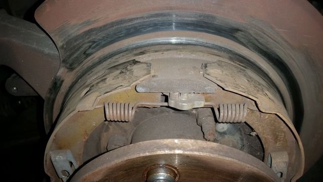

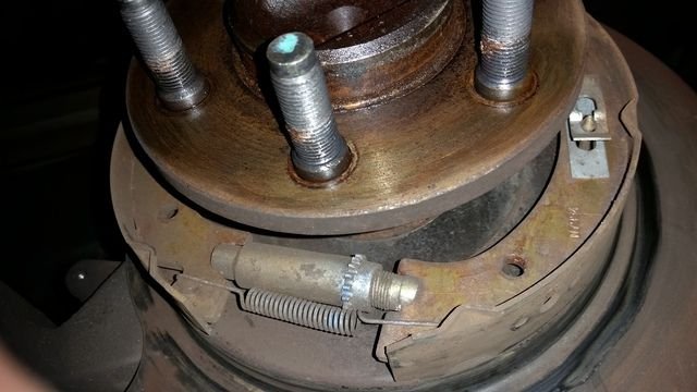

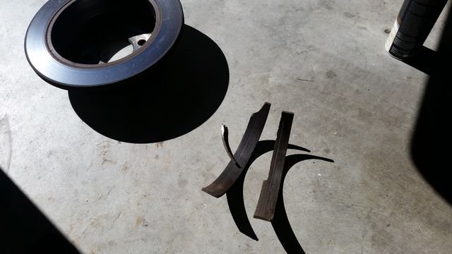

I'd say the truck is definitely the problem. Don't kill your pocket... you should try the salvage yards. Plus you'll probably get get the benefit of seeing how they're set up before you pull the parts. Used to visit Harry's in Hazelton back when I lived in NYC.
Be aware there are about three pages to flip thru. https://wegotused.com/our-inventory/?inv[yard]=all&inv[make]=DODGE&inv[model]=DAKOTA&inv[manufacturer]=CH&inv[year]=&inv[part]=&inv[page]=1&inv[sort][yard_date]=0&inv[sort][yard_city]=1
A few pics of the E-brake setup I took many years ago... I might be able to take one of the back side this weekend. If the shoes look naked, it's because the linings fell off. LOL
