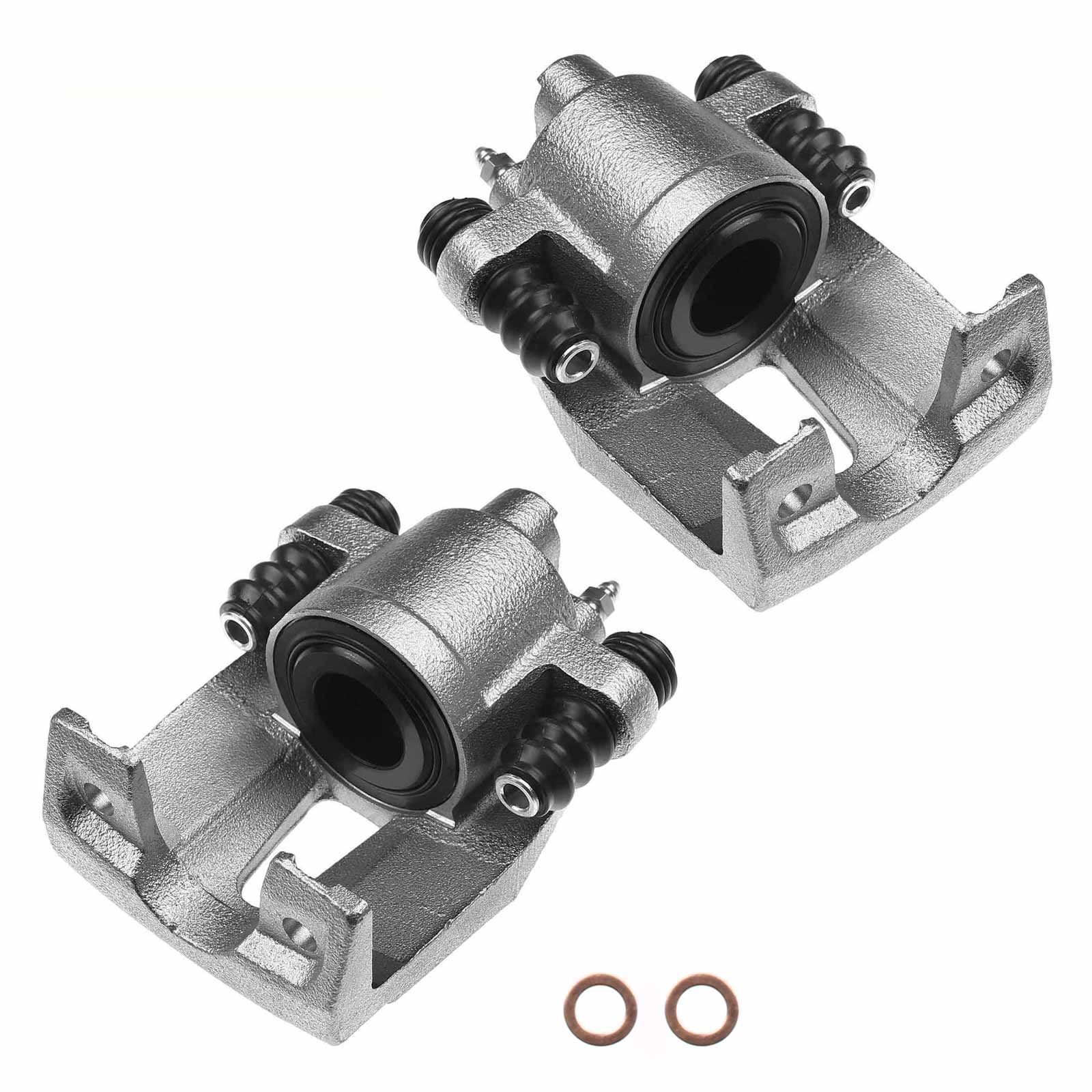

Possible. Can you post pics of your calipers?

These are the calipers. You can see the bleed nipples in this pic.
This is how I bleed my 2003. Two man method is great too, assuming you have the help.

Sorry its too hard to get a good picture. It probably is broken off I just thought it weird htat both sides were broken off. I questioned if their was some auto bleeding method that I did not know about.

Nope. Gotta be able to release the air from the system somehow.. You *might* be able to extract the broken bleeders, and just replace them, but, for the 'hassle factor', simply replacing them is generally MUCH easier.
