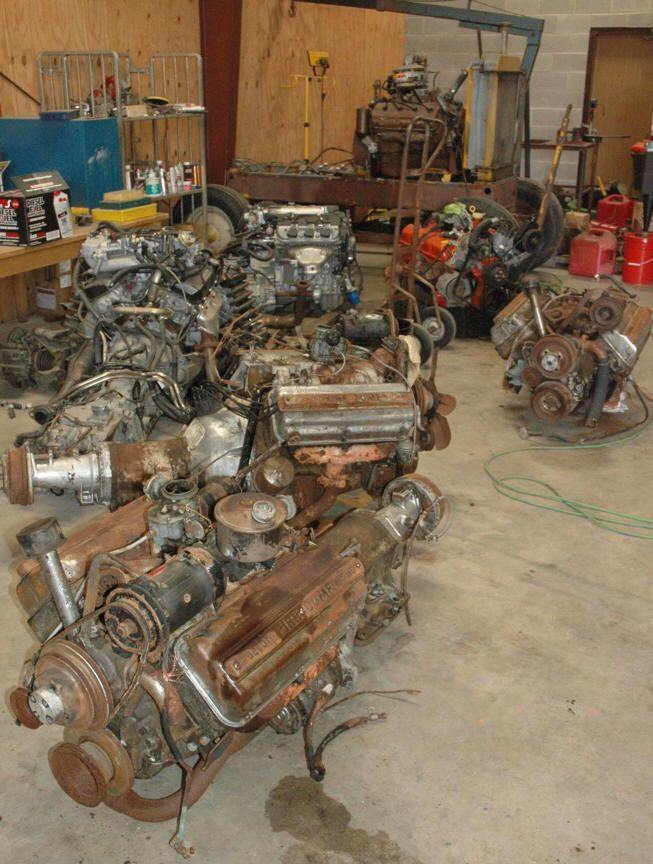

Thus when the "new Dakota" hits dealer lots its most likely going to be a D50 size truck not a historic Dakota mid-size. I know investors and dealers that are buying all the later generation low mileage Dakotas they can and putting back in storage as prices keep going up on our beloved Dakotas. Rather than put probably $40,000 to $50,000 into a tiny D50 size Fiat that will likely be a plastic and beer can thin aluminum truck restore the 1993 with a $15,000 to $20,000 budget and shop for a nice clean third generation 2009 to 2011 truck. Found one recently with under 25,000 miles but had short bed but am looking seriously.
In addition to downsizing the Dakota on re-release (told the three cylinder option is likely going to be the base model) Ram/Fiat is about to discontinue the Hemi for a new "Hurricane" series engine, Thank the Lord there are millions of Gen 3 (really a better motor than earlier Hemis) Hemi's in junk yards and planning to buy several to put back with my old Hemi collection. Yes, this is a pile of Hemis.have hoarded back and have a room full of transmissions including six NOS 727s purchased at an Air Force surplus auction.
Have enough vintage Mopar parts and such could sell and go buy truck of my choice but all new trucks are plastic and beer can subdivision cruisers unless get into 3500s then add a half ton of armor to protect the plastic parts on them. I am not buying any Tuck branded as a "Ram Truck" if it does not say Dodge on the sides and back end have no use for it. Wife wants another Club Cab long Bed 2500 diesel and looking for a 2003 that's clean or earlier as post 2003 the Cummins is not what built their reputation. Came across a really nice 2001 2500 Cummins 4WD and laughed at seller for asking $20,000 so passed information to a friend who paid the $20K, had it detailed from exterior, underside, interior, did a proper service then sold it for $30,000.
Lots of folks like me are wanting clean, low mileage Dodge trucks with less electronics rather than newer Ram trucks have discovered clean ones with under 50,000 miles can bring almost price of a new one. Why I bought the 2007 Hemi as was garage kept with only 40,000 miles. Original owner was a banker who used it to carry golf clubs and go deer hunting. Plan is find wife her 1999-2003 2500, restore my Dakota, sell this new Colorado then possibly restore my 1997 Club cab with a Mopar crate motor as a start. These four door trucks with short beds are useless for work, add a long bed and can't park them in most parking lots or fit in garage. Really miss the club cab option as like some room behind the front seats but still want a long bed that's not so long its tail end hangs four feet out into lanes of parking lots. Have had our 2007 Mega Cab Long Bed purposely vandalized with perpetrators leaving note once and keying message into paint once not to park such a big truck in parking lot and block traffic. Ram trucks are not what Dodge trucks are and soon when the Hemi is gone will be the end.
