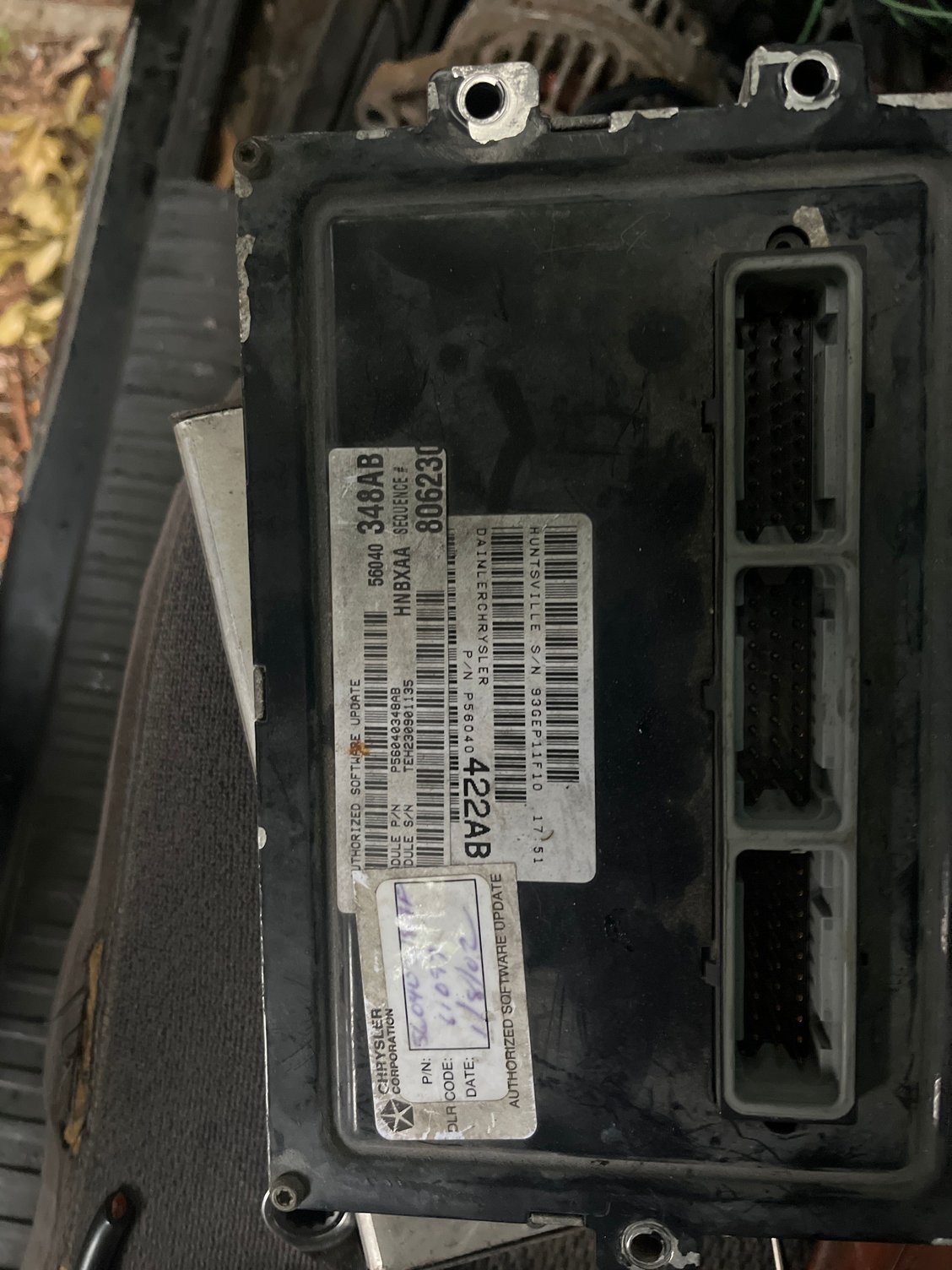

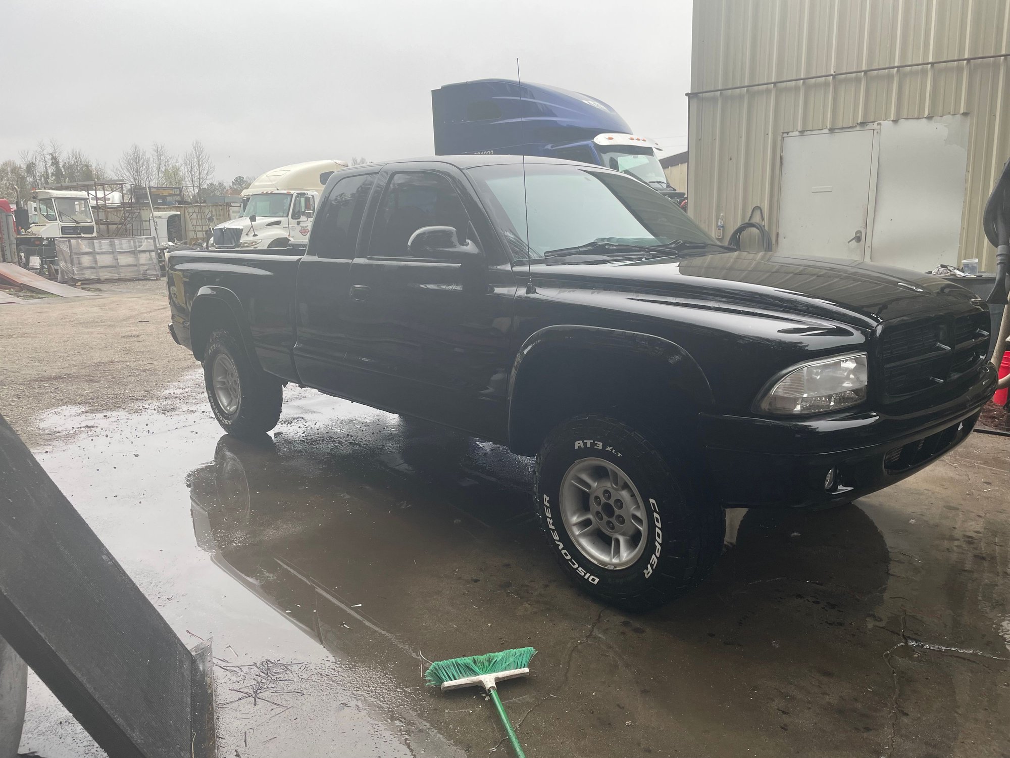

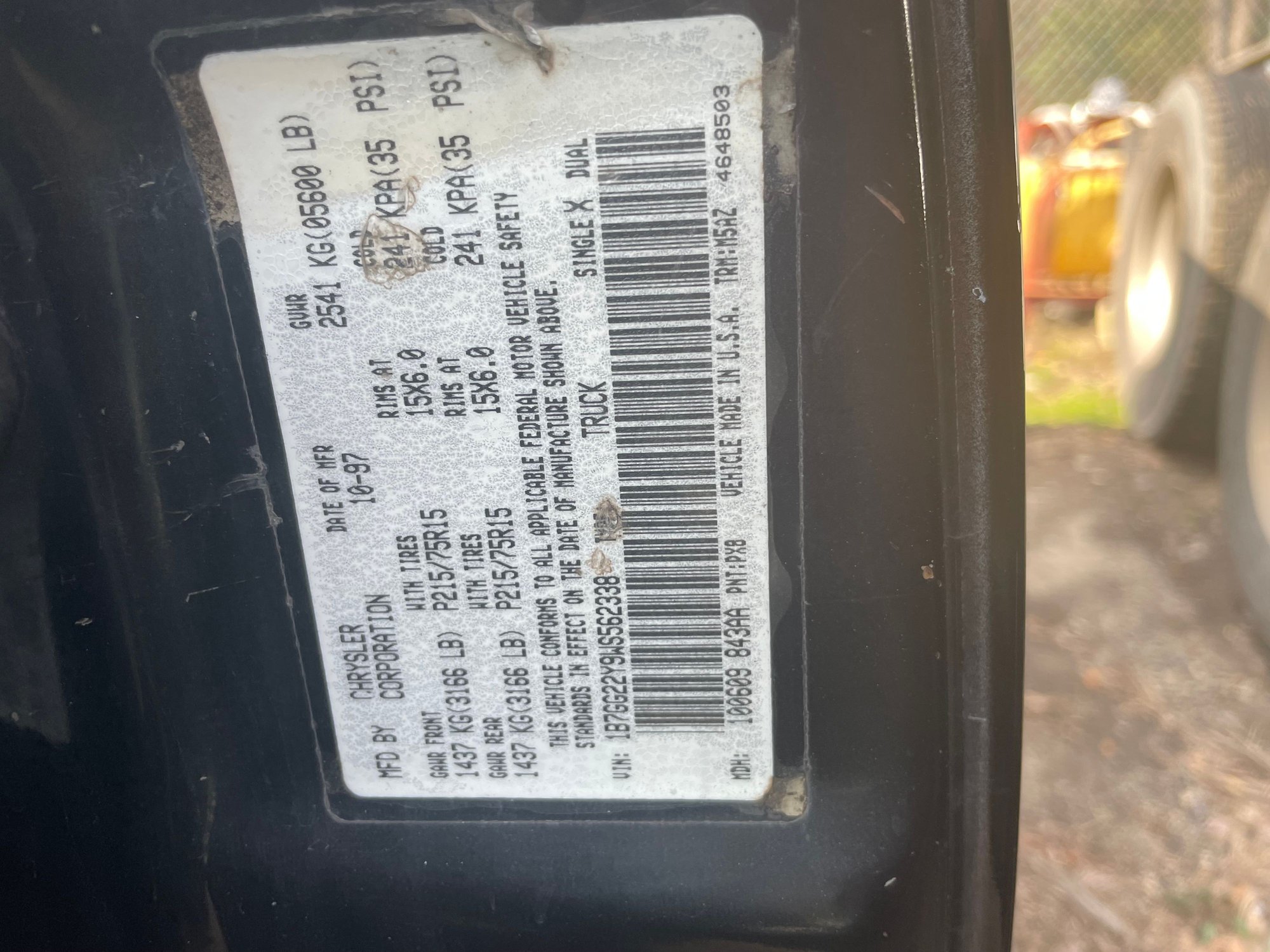

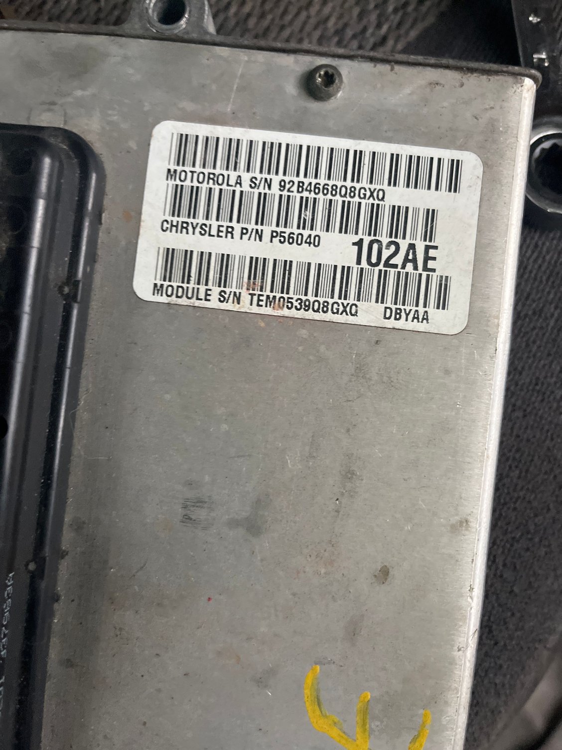

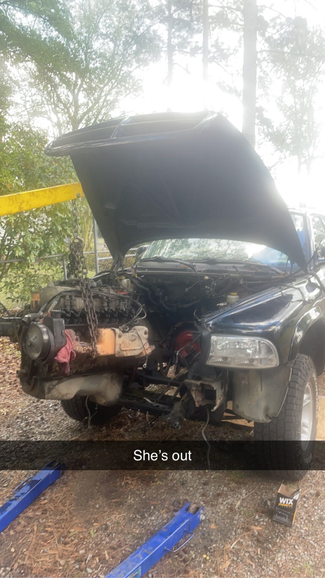

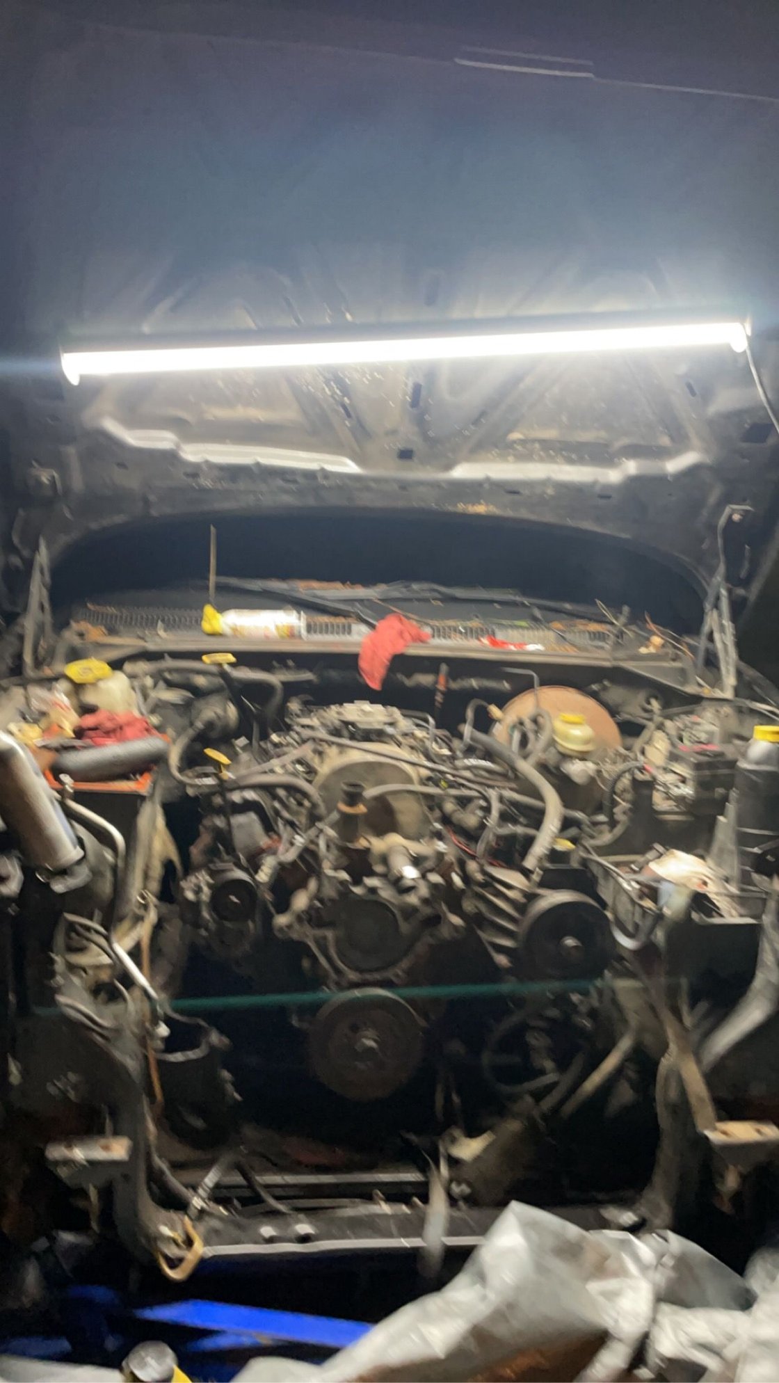

Hi I have a 98 Dakota 5.2 recently replaced motor with same motor from a 97 ram 1500. I have checked my asd relay everything was good there have power where I’m supposed to relay tested good on my relay tester. The issue I’m having is I have no power to my ign coil which is giving me a no spark no run problem. I’ve replaced my crank POs sensor and fixed any bad wiring. Tried a test pcm from a 98 Durango 5.2 no change in problem. Checked all grounds and replaced main grounds at battery. Replaced power wire from fuse box to battery. Replaced lock cylinder and ign switch. Have fuel pressure at schrader valve on ds rail. Inspected harness from pcm all the way to the ds firewall. Can shoot either to it and get it to run momentarily but after either runs through motor she dies. Fuel gauge and oil pressure battery gauge works but that’s it no rpm. Engine temp is into die to bad sensor but that won’t stop from running. No lights in dash scan tool communicates properly. When engine was replaced the original motor blew #7 connecting rod cap off so I swapped all engine accesories onto my donor motor as well as the intake manifold since the connectors were different. Battery is a brand new interstate I’ve load tested it and charged it every time it’s been out more than a week. Read the cam shaft POs sensor could be a problem or pcm. If it was a pcm though wouldn’t the truck run with my test pcm or does that have to be exact pn/sn to work? Also haven’t rechecked timing but even if timing was wrong the truck should still run just run rough I would’ve thought. I am a heavy diesel mechanic and this is my first gas job motor swap I’ve done and it’s really humbled me haha. Any helpful insight or tips to fix this is much appreciated. Only light coming on in dash is Check gauges scanner showed a p0320 code before crank POs sensor was replaced but no codes since then. Motor was swapped back in nov 2023 and I’ve been tinkering on this truck on my free weekends when I’m not on a mobile repair call. Thanks in advance.
Original pcm
Test pcm from durango 98 v8
Test pcm from 99 Dakota v6
