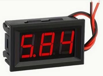

2nd unit fixed different issues. bottom line--- I put the orig PCM back, As it only had the one issue, disregarded what the dash reported, and used an aftermarket
( similar to stock photo )
digital voltmeter less than $2.00.
I mounted it atop left side of dash eyebrow, in a small housing.
I wired it to the hot side/& gnd of the fusebox . No problem ever since, with the added distinction of knowing Exactly what the voltage is to the decimal........ with the key on, or off!
It shows 13.4 volts when charging. Now ,I know what's what, at all times.
