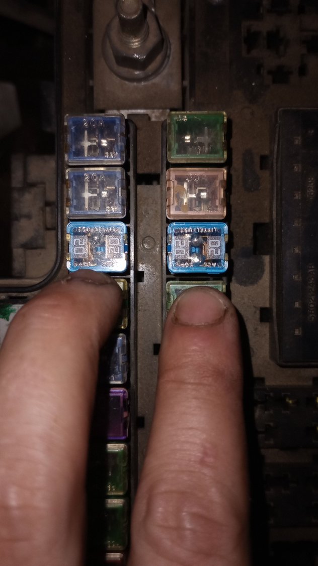

​​​​​​No. My right headlight still works, my left headlight hasn't came back on since I replaced my BCM. Yes, replaced both. The original ones were two different 20amp breakers. I bought two of the same kind. I'll send you a picture when I get home.

The new ones
The old two
The old ones

Okay, looks like I misread one of your previous comments. I thought you said the working light switched sides when you swapped the fuses. Do you have a volt meter? If not you can probably rent one from a parts house.
Turn on the lights then Pull one of those two fuses to located which one is which side. After you have figured out which side is which insert the positive probe in one of the slots of the dead lights side. Make sure to check both slots to ensure you have the hot side. Then ground the negative probe on the battery. If it show's voltage then we know the break is further down and likely a broken wire or bad connector. If it doesn't then you know the break is on the other side and should see if you can get the fuse box pulled up. Sometimes the bars underneath get corroded or damaged.
