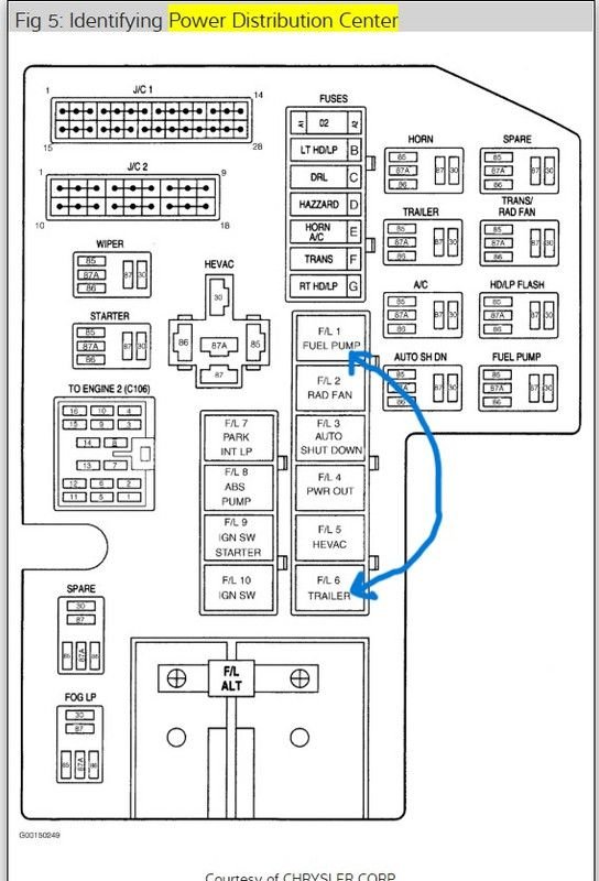

Try the cheapest fix first! Go in the under-hood fuse box and try swapping out the fuel pump relay with another. There are many identical relays, I suggest the trailer relay, if you have that. If that's the issue (it was for me and I was convinced that my pump was a goner based on mileage alone), then just replace the relay.
https://dodgeforum.com/forum/2nd-gen...ng-320k-3.html
I'm absolutely going to try this! Cheap and easy first, no doubt.
