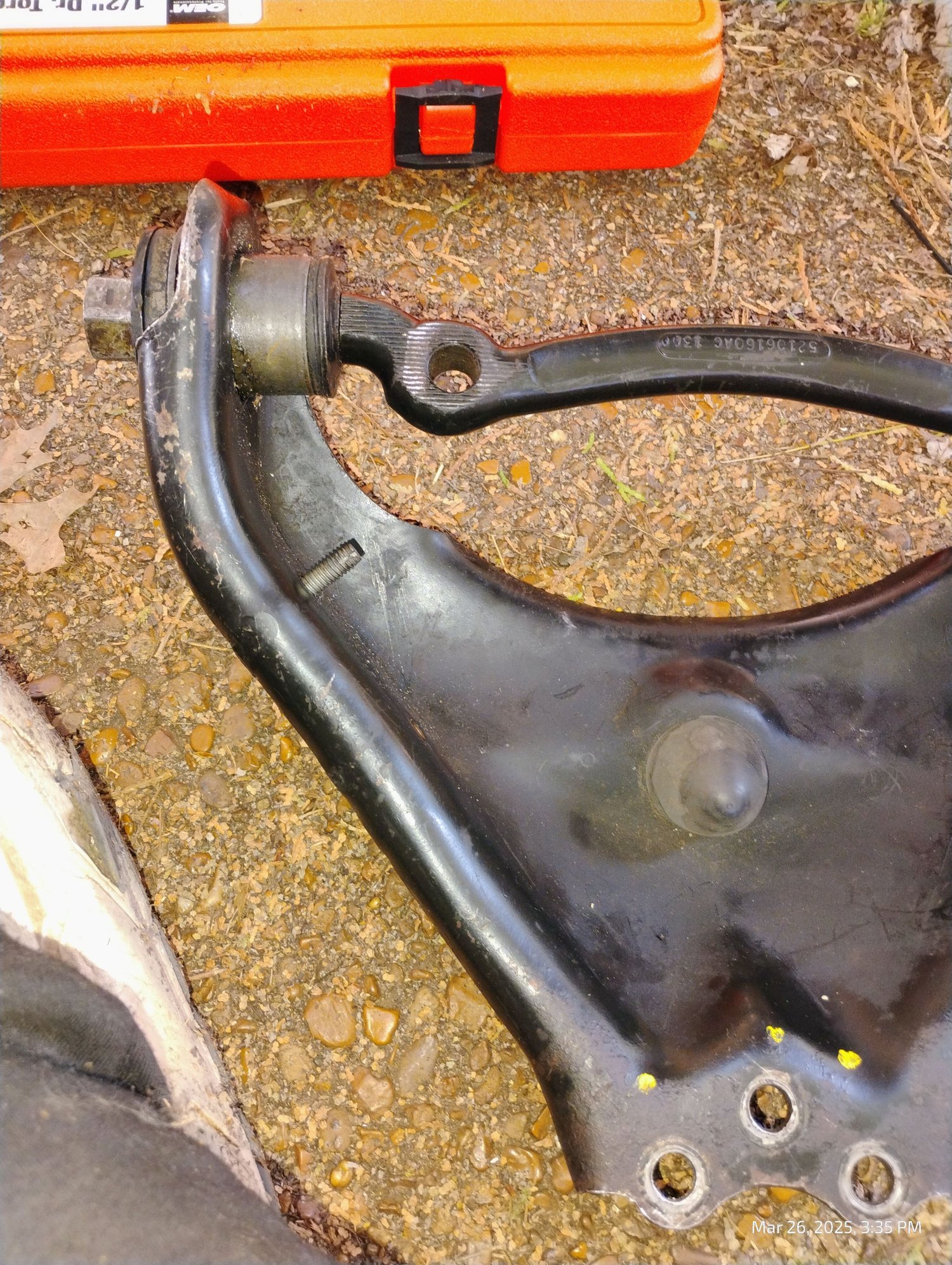

Why is it so tough to find a passenger upper control arm for a RWD online ? 4WD are all over ,an some companies don't even stock rwd .What gives?
I ordered one but it's a to a 4wd Dakota (an it's incorrect on pivot bar )... maybe I can switch out the new bushings an keep the original bar since that seems to be the only difference....What technique works on getting the darn bushings out ?
I tried the big C clamp / ball joint press to no avail an the big 3 jaw puller too....but with a middle bar I can't get the leverage ..
Winder how much a shop charges to use their press on em ..
Any suggestions are appreciated.
Thanks .

But ..is yours 2wd ? I 1st bought the bushings thinking hey this won't be too difficult w that ball joint press or jaw puller ...boy was it..With pressure, no good way to directly an straight ,push em out.
Again why is the 2 wd so tough to find online? .. By the time I try to return the 4wd one an pay 15 more bucks id be buying a new ball joint ..alone . Assembly was just 63 bucks. ..so I decided to keep it an put the ball joint off it ,on mine later ..I have to figure out how to get my original bushings off.
Any tools I may try besides those 2?
I'm gonna try a smaller 3 jaw puller ..

That popped the pivot bar out...whew .
Used a smaller 3 jaw with flat edge lip..but only 2 sides..
Push the center thru.
Gotta hammer out or C clamp the bushings.

Got the new ones in.1st one with big C clamp an last one in w 2 jaw puller ( tricky to do but with a metal cup an the 2 jaw puller you can press it in ). See pic
I looked at the other upper control arm -(drivers side )and saw that it is NOT built as the passenger side with that bend in the pivot bar..why did they make one side -passenger -bent in ,an the drivers side straight? An no they are not interchangable.

Nope, open area w 2 bolts sticking up..with plenty of space..I saw another post where a person's Dakota had it like that too ..odd..

Maybe it has to do with camber an other adjustments? Wonder what the shop manual says ..
I didn't recall the direction it was turned but I think it goes in as 1st pic..correct?
Not 2nd one
Correct?
