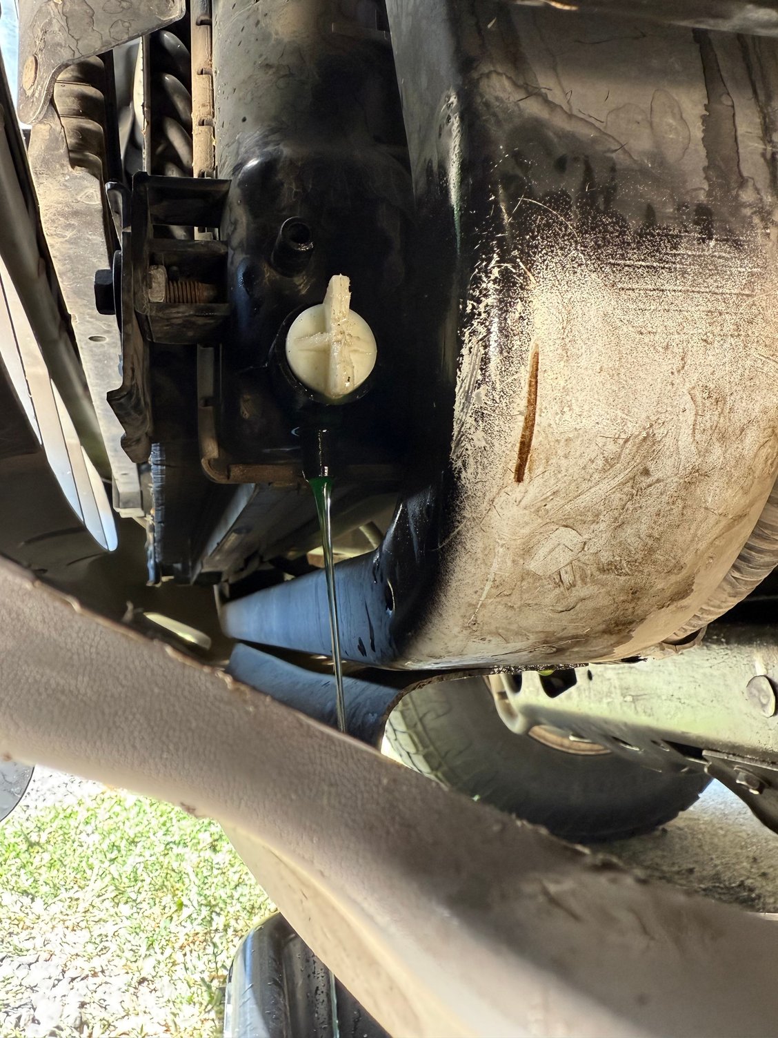

Hoping someone can help. I swapped my water pump this morning and when I re-installed the radiator plug and added coolant, it started leaking from the small drain below the plug.
I’ve got a picture of the issue and of the plug. I can’t seem to find a replacement plug anywhere (in store or online) or even a picture of the one I have to see if it had an o-ring that fell off.
2003 Dakota SLT 4WD, V8, 4.7L
Any help would be appreciated.

Yes, there is supposed to be an o-ring there......

Any ideas on how I might track one down? I can’t seem to find this exact plug anywhere online.

Look in the radiator, see if it isn't still in there, and just not in the right place. Or, look in the bucket of old coolant.
I *think* the Oring goes on the nub on the end of the plug there.... I think..... so, might go to the parts store, see if you can find something that'll fit.

Addendum: I think your radiator has been replaced from stock.... Your drain plug doesn't look anything like the stock unit..... Totally different......

I did end up getting an assorted pack and found one that fit on the end and that sealed it right up. I couldn’t see the old o-ring inside the hole so assuming it must have been flushed out. Thanks for the suggestion!

Hey, it worked! Awesome.
