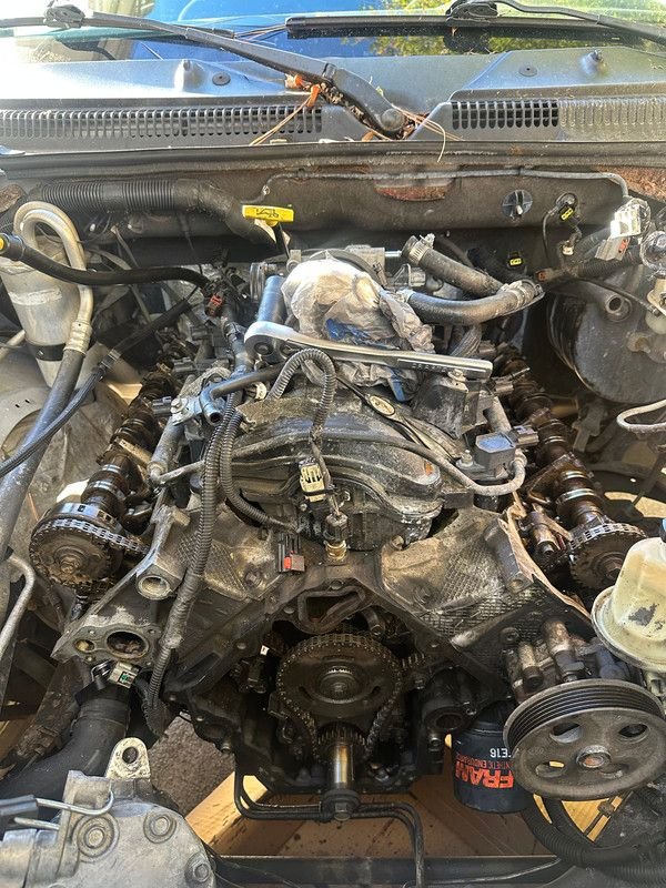

Pulled the timing cover today. Oh boy...
Old Oct 23, 2025 | 02:51 PM
Dodgevity's Avatar
Dodgevity
Joined: Oct 2013
Posts: 3,775
Likes: 449
From: Atlanta
Making slow progress. Getting ready to swap out timing chains. Just gotta remove that PS pump next so I can get to the chain guide bolts. I threw all the bolts into a plastic bag. Didn't even bother to label them. Lord help me. LOL

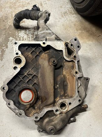

Got in the new gasket set today. I'm guessing the tiny o-ring is for the CPS but not sure what the one on the lower left is for. Any guesses?
File Type: jpg
Old Oct 29, 2025 | 09:10 PM
Posts: 87,482
Water passage on the upper left side (in the picture) of the motor?
Old Oct 29, 2025 | 11:51 PM
Dodgevity's Avatar
Dodgevity
Joined: Oct 2013
Posts: 3,775
Likes: 449
From: Atlanta
The gaskets go on the timing cover. The somewhat triangular gasket goes up top (top right in this pic)and the two large o-rings on the others.
Old Oct 30, 2025 | 09:38 AM
Posts: 87,482
Wouldn't be the first time I got gaskets in a set, that weren't applicable to the vehicle I was working on...... There may have been changes over time, and the company just includes everything in one set, to avoid having yet another part number.....

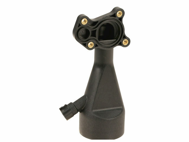

Figured it out. It's the gasket for the oil fill tube. https://store.mopar.com/oem-parts/mo...ket-53020889ac

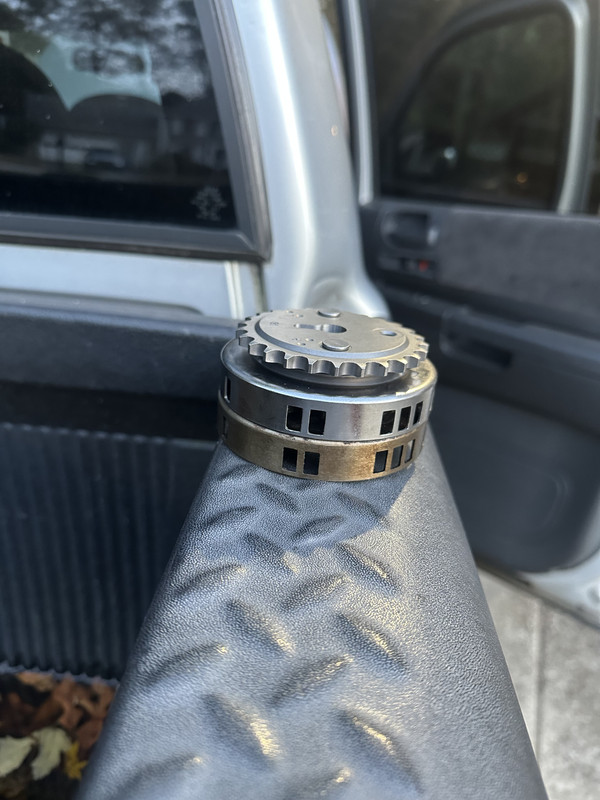

Ever do something so stupid you decide to keep it to yourself? Well, earlier I was about to post how I got the wrong timing kit because I got the wrong target wheel. I deleted everything and figured I'd give you guys a laugh. I actually stopped working and put everything away....then it dawned on me. I blame it on being tired but sheesh! I had them turned face to face when comparing them, instead of the proper way. LOL....
Anyway, they do match when turned the right way.
I was even contemplating using the old sprockets with the new chain. Well that would have been a disaster cause I counted 26 teeth on the new target wheel and 30 on the old. Same thing for the other cam sprocket. You can see the difference here. I assume this means the chains are different. Never good to mix these things. I hang my head in shame.... back at it again tomorrow. First timing chain job ever, so I'm learning. LOL

Every job is a learning experience. Some lessons are far more pleasant than others. Be happy you discovered the problems BEFORE you were attempting to put things together.
