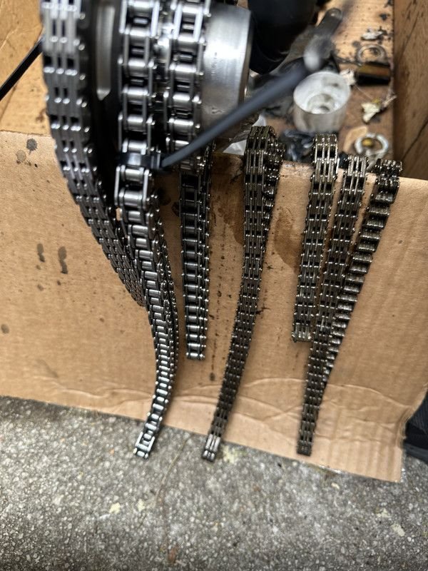

Today I learned why the sprockets look so different and have a different tooth count. The Cloyes kit I received uses roller style secondary chains (main chain is still inverted tooth), vs the inverted tooth style, which is what my truck has for all three timing chains. Chrysler made the updates later on the 4.7. Here you can see what I mean. The old chains are on the right.
Now since I'm changing everything over, it should work but one problem. They also updated the secondary timing chain guides to have pivoting bushings in them. Mine just has holes, thru which there are torx bolts. The torx bolts don't fit thru the new bushings, so again, I packed it up for the day. Will call Cloyes tomorrow and see if they can send me some proper bushings (they pop out).

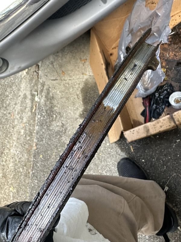

Fished out about three more large pieces of the plastic guides that broke apart. Do you think these were at end of life? Incredibly, the chains look to be in really great shape, just not the guides.

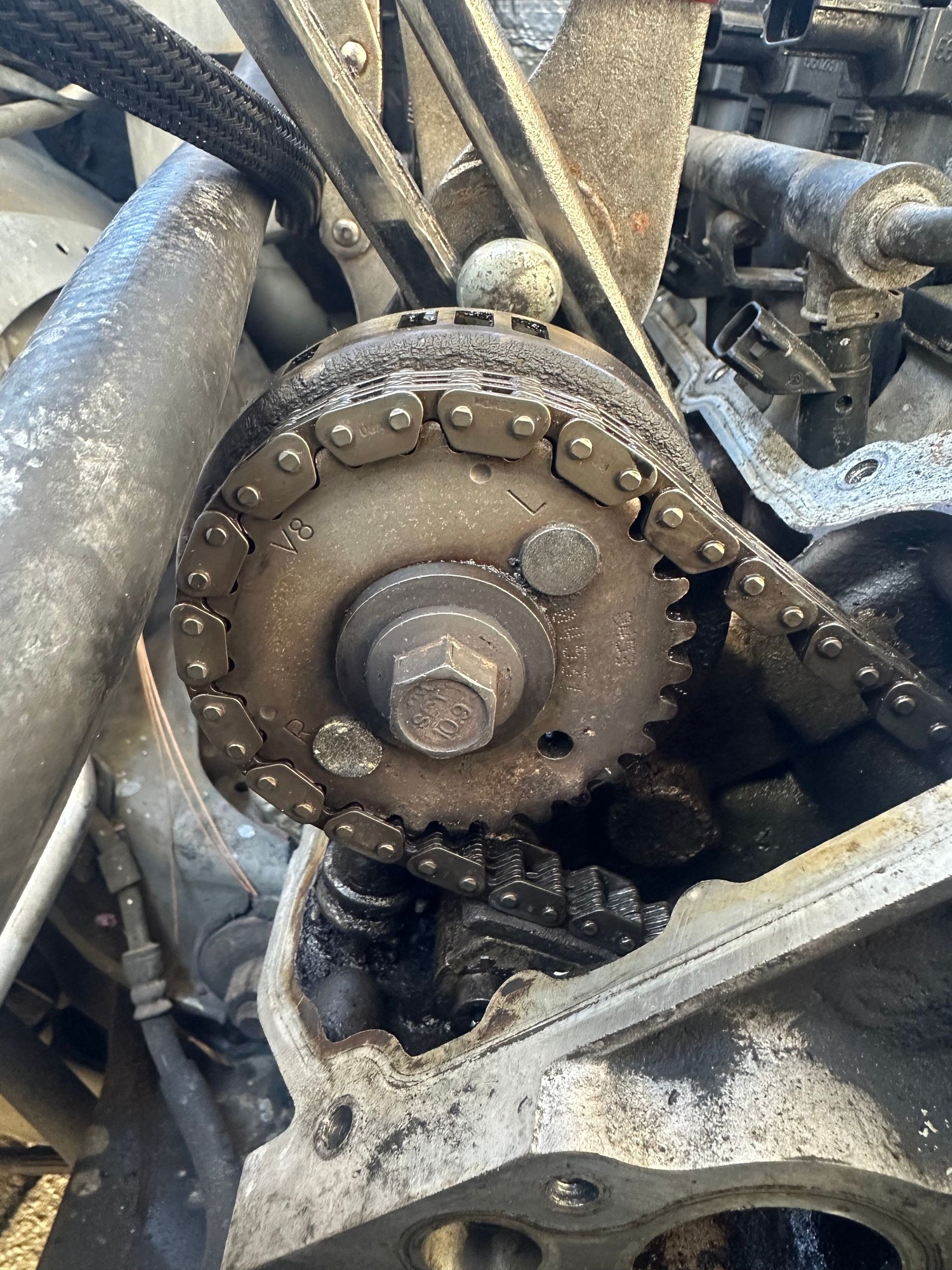

When I was trying to remove the sprocket with the tone ring, I tried doing it manually by gripping the camshaft with a vice grip and using a wrench. Well, the spring pressure caused it to roll anti-clockwise from the 12:00 to the 10:00 position. The "V8" is supposed to be at 12:00 in the pic. I wised up and pulled it and the rest with an impact wrench instead. I tried rolling it back but it's hard as hell to move. That's going to be a problem when I go to put the sprocket on. I'm going to remove the spark plugs on that side, to see if that will make things easier. If you guys have any other ideas, I'd appreciate them.

Pulling the plugs won't matter. It will make turning the crank easier, to a point.... but, the cams will still be fighting the valve springs.
What does that bolt get torqued to on install? Could you turn the cam with a wrench on the bolt, without being in danger of breaking the bolt?
It gets torqued to 90 lbs ft.
Should be able to use that to turn the cam then. I would hope it doesn't take that much torque to spin it.

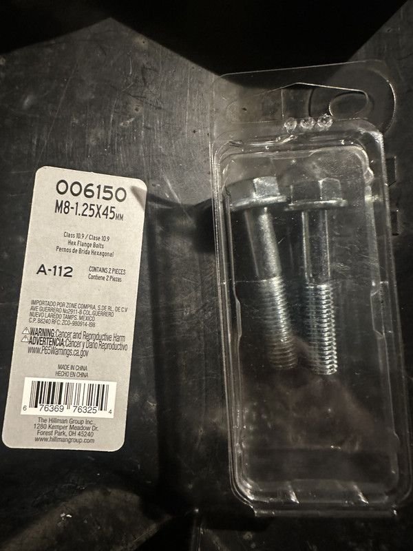

Spoke with Cloyes and they said I had the wrong timing set. The roller chains are for the later iterations of the 4.7 (2008 and up Dakota). At first they tried to tell me the tone wheel was different too, but the guy admitted that he got that wrong, once I sent him the pics. So it seems the roller chains and sprockets are the big difference. The bolts for the secondary guides are different too, due to the pivoting bushing. Well, I guess I'll consider this an upgrade then. I looked up the 08 guide bolts and they are ten bucks each + ship, LOL. I googled the bolt specs and got these from Autozone for five bucks, so I'm good there.
