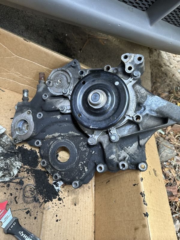

Pulled the timing cover today. Oh boy...

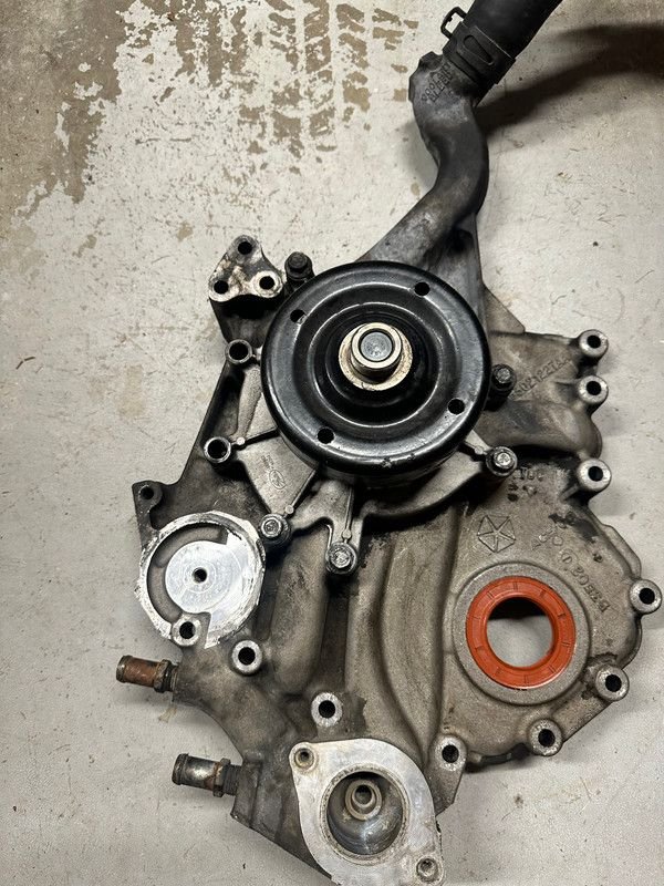

I've come to realize another benefit from the timing chain job. All these years, I've had an oil drip which I thought was due to a rear main seal leak. Well, it's not dripping any more, so I think it was the crankshaft seal all along. And it makes sense when you see the before and after of how much crud I cleaned off the timing cover. It was so thick, I started by scraping it off!
I also no longer believe the Federal Mogul/Sealed Power lifters that I installed back in 2020 are junk, though it's still possible, LOL. The fact is that most or all of the clatter I was hearing was the chains running without guides or on worn out guides and tensioners.
