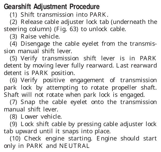

This is from the FSM:

Broken shift cable housing !! Thanks for the help !
