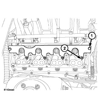

Originally Posted by SweetZrag
I had no compression in cylinders 6 & 8. The pushrods for the intake valves in cylinders 6 & 8 are not moving.
There is an alignment tool you can use so that doesn't happen. It's not uncommon for the push rods to not get seated on the lifter.
https://millerspecialtools.service-s...il.aspx?id=766
Thanks TNTech. Under the "Current Usage" for that tool, it starts with 2006. Mine is a 2004. It does show body type HB which is what I have. Will this tool work for the 2004?
I am going to pull the intake rocker arm assembly tonight to take a closer look. My fear is that the oil passage in the block is clogged and not sure how I will clean that without taking the entire engine apart again. Do these 2 lifters share the same oil passage? I am also going to have someone crank the engine while I check if oil is squirting through these 2 pushrods.
If the pushrod is not fully seated into the lifter, wouldn't I still see movement as the rod rides up and down on the edge of the lifter?

The same tool number for a 2004 Hemi.
