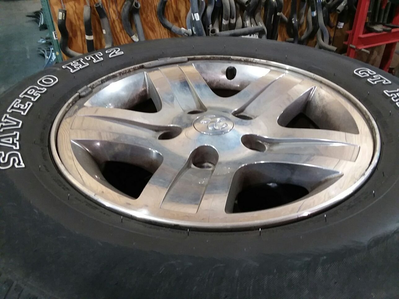

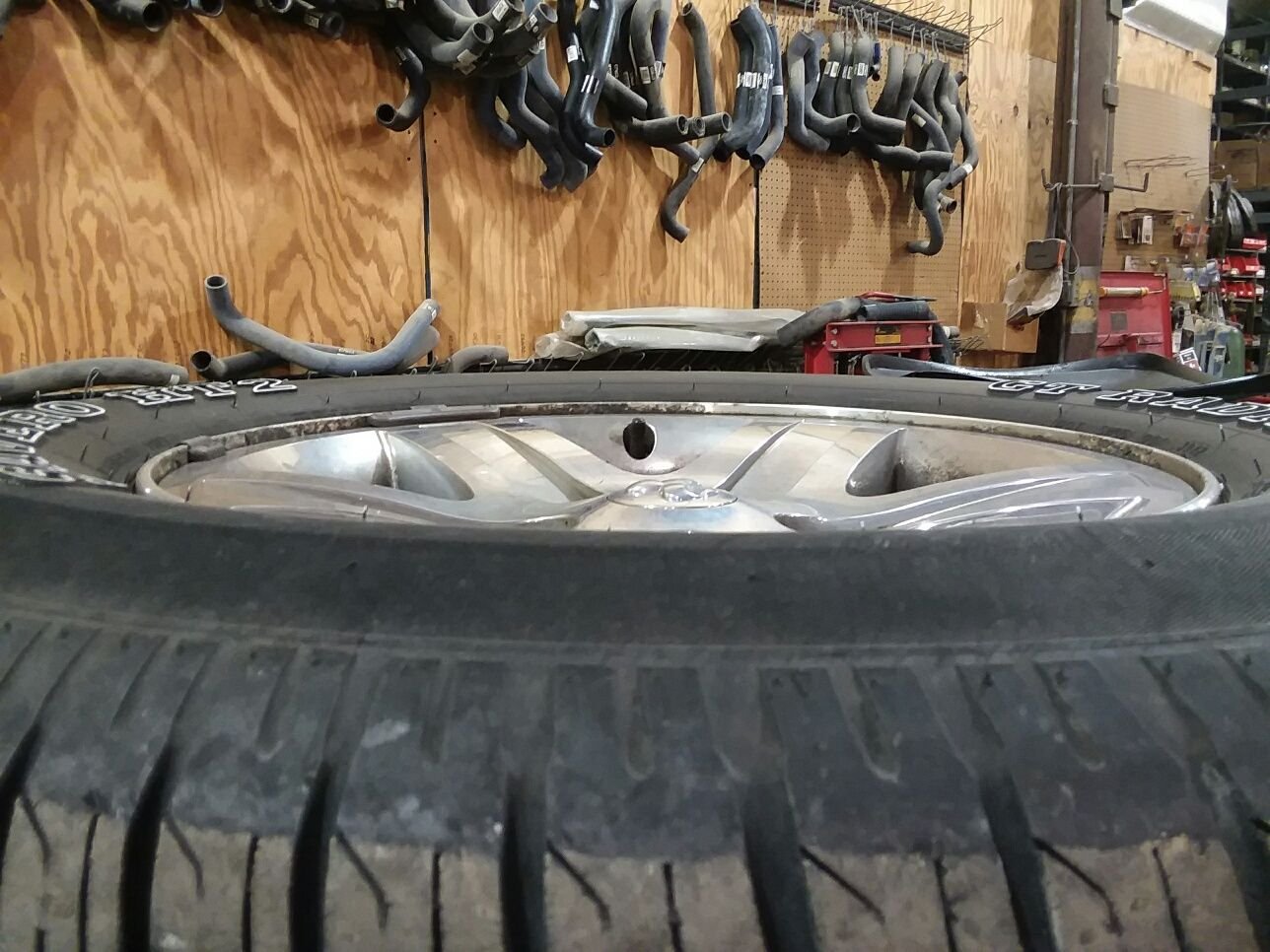

post a pic on your rims near the bead seat where the heads clip to the rims.

The stock wheels & tires that came off of vehicle are perfect. low miles on them . i'm gonna sell them . there the chrome plastic covered alum.17" wheel.(LTD) perfect tread ware & all, there nice . we just went bigger tire the OE tires are 30" The new mud tire is 32.7" (33"s - 2" taller & 1/2"wider in a 70 series) both tires bulge out over the bead lip stock & oversize. I would assume it would need a TIRE MOUNT alignment head regardless.Not much of a lip here are some photos as asked.
stock tire & wheel

they could mark those rims. put on the other set.
make sure they provide you with an alignment printout. inspect your treadwear pattern for irregular wear at every oil change. you want to catch bad alignment results early before they toe wear expensive tires.
