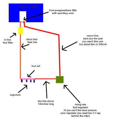

ok plz discribe your feul system everything feul related you have on the car right now

ok, right now, i have a stock pump, with 23 lb injectors, and a 10:1 fmu......
it leans out as soon as it reaches about 2 psi build up of boost
so i guess instead of asking so many questions, what is everyone running for fuel with there second gen neons??? i need parts lists, and specifics, i am getting the welbro 255 fuel pump, but i need to know, if i HAVE to run a fuel return or are there other options??? what is the most common way to run the fuel systems for the neon??????????????? and remember dependable fuel system

how are you runing the 10:1 if you don't have return line also what brand is the 10:1 can you set the base presure with it.
ok I here is how mysetup used too look like before ms
walboraro with spool boy mod-----feul filter out a turdo dodge---stock feed feul line---stock feul rail with 30lb's enjecters---12inch 4an line out the scredar valve--- chill factory 8:1 feul regulatur--- 6an return line back too the feul tank
hope it helps
with the 21 enjecters you want too set the base presure around 52psi and you don't want too run more than 5psi of boost

how does ur car run, at idol and at boost, does it ever go into lean at all?? i think i am going to run the rrfpr that rt is selling, so then i know that i have enough fuel, i am going to hook the pump up and return line system that i am going to do on saterday and see if that helps me with fuel flow, it may be ok with the injectors, and the 10:1 i am running.....i will send an email out when i get home...thanks

no my car idle was right on it did go lean when you go into boost but almost all rrfpr car do it
I made you a daigram

dangerously lean into boost???
thanks for the diagram, helped me out alot....
i love the MS paint drawing lol its cute lol jk now i understand the fuel return.
